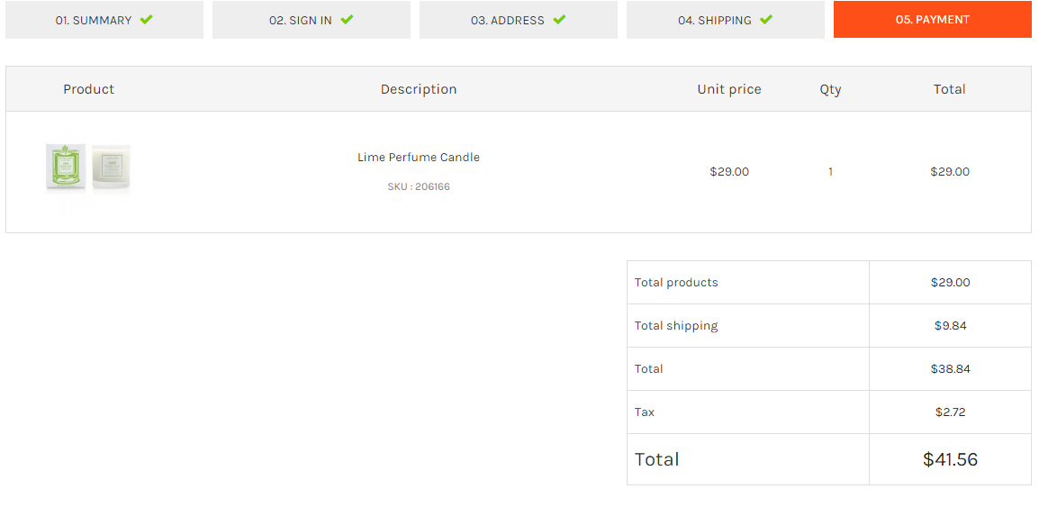

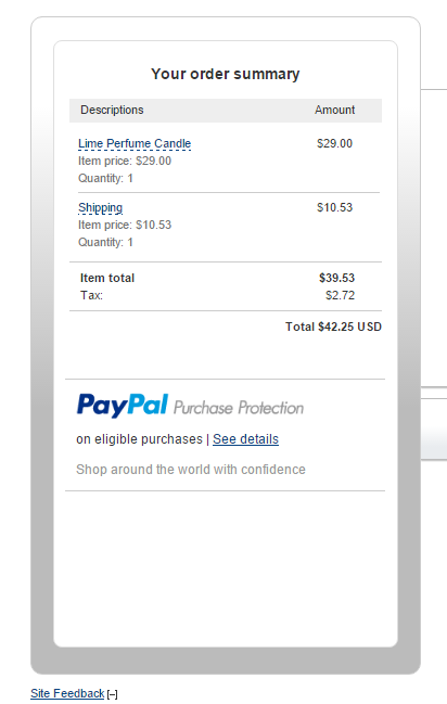

jamess Posted December 23, 2015 Share Posted December 23, 2015 Prestashop 1.6.1.2 PayPal USA, Canada Module 1.3.9 I'm experience a shipping tax problem on two different prestashop sites using the PayPal module (referenced above). The total is wrong because PayPal is adding shipping to the tax, when Prestashop is adding the shipping tax to the tax total. As such, PayPal double taxes the shipping. I've attached two screen grabs to show the issue. Shipping is taxable at 7% for FL residents. For now, I've had to turn off taxing shipping, but that's a problem. Any ideas? Thanks for your advice. James Link to comment Share on other sites More sharing options...
bellini13 Posted December 24, 2015 Share Posted December 24, 2015 I believe this should resolve your issue https://github.com/PrestaShop/PrestaShop-modules/pull/359/files I submitted this fix to them over a year ago, and they have done nothing with it. 3 Link to comment Share on other sites More sharing options...
jamess Posted December 24, 2015 Author Share Posted December 24, 2015 That's it! Thank you, James Link to comment Share on other sites More sharing options...
