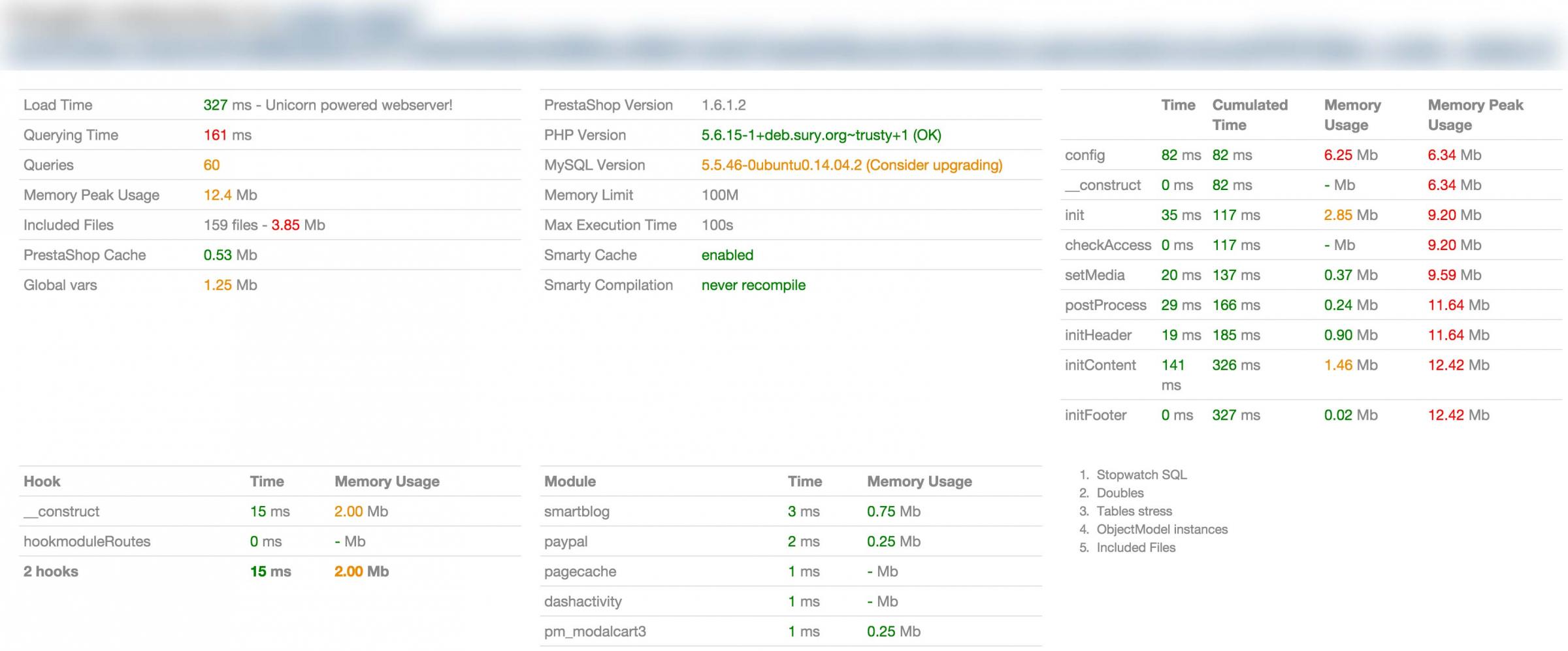

andersburn Posted December 22, 2015 Author Share Posted December 22, 2015 I get this right before the PDF's are generated. And then a blank page right after. Link to comment Share on other sites More sharing options...
andersburn Posted December 22, 2015 Author Share Posted December 22, 2015 Well i tried stuff, i made a new server with: max_execution_time = 100 max_input_time = 30 memory_limit = 100M That one couldn't do 270 orders at one time. So i tried to max_execution_time, that didn't do anything. So i get it 2x ram, and it worked. Thanks. Link to comment Share on other sites More sharing options...
