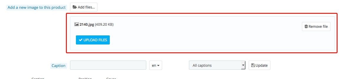

stuffedhippo Posted December 17, 2015 Share Posted December 17, 2015 (edited) This has been working OK and I have not changed any back-end core files. If I try to upload a product image I click ADD FILES then select the files form my computer but then nothing happens. Usually in the admin you get a reference to that image and and upload button. Anyone else had this problem? It is also a problem with the category images. Strangely manufacturer/supplier or CMS images upload OK. I have checked file permissions and all is OK Running 1.6.1 Attached is the area that does not appear and through FireBug nothing is in the hidden element. Edited December 18, 2015 by stuffedhippo (see edit history) Link to comment Share on other sites More sharing options...

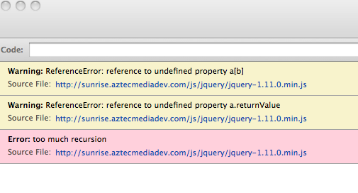

stuffedhippo Posted December 18, 2015 Author Share Posted December 18, 2015 After more delving I have found there is an error (in firebug) when uploading a file in the admin: Link to comment Share on other sites More sharing options...

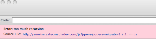

stuffedhippo Posted December 18, 2015 Author Share Posted December 18, 2015 Same problem with the CSV import: Link to comment Share on other sites More sharing options...
studiopelex Posted April 3, 2016 Share Posted April 3, 2016 Hi, i have now identical problem with upload photo to products.Problem Uploading Image To Products And Categories "error: Too Much Recursion"Did you find a solution?I tried remove all file and code from sql base, and upload old backup file, but error still is in system.I try two days fix my presta, but now i don't have idea what.Thanks for your helpAndrew Link to comment Share on other sites More sharing options...
