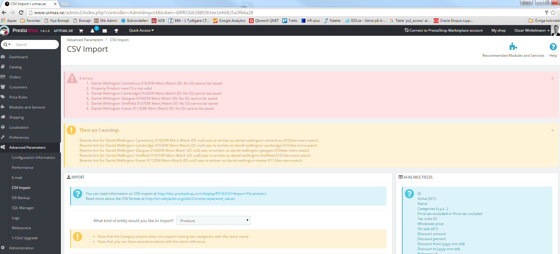

oscarw Posted December 8, 2015 Share Posted December 8, 2015 Hello from Sweden my Prestashop-friends! We are experiencing problems uploading a .CSV productfile in Prestashop, even though we have mapped all the field right to the file in Prestashop. We also tried to ignore empty fields when uploading the .CSV. Our web provider have increased the time for max_limit in php.ini to upload the file on the webserver. We have also tried to reduce the file and only take in 5 products in the file and then we get the following error: (see attached picture). We have also changed the authorization of files and folders to 755 on the ftp with no results. The times we have tried to load the entire file and to ignore the empty fields, we get a: Server 500 error, but we succeed to load about 180 products, I've also tried to add all the fields possible for products of PrestaShop and then get a server 500 error Please help me or give me a gun! has been stuck for five days now!! In php-error log: [07-Dec-2015 15:52:37 Europe/Stockholm] PHP Warning: imagejpeg(/storage/content/81/145081/urmax.se/public_html/img/p/1/1.jpg): failed to open stream: No such file or directory in /storage/content/81/145081/urmax.se/public_html/classes/ImageManager.php on line 541 [07-Dec-2015 22:18:50 Europe/Stockholm] PHP Warning: Division by zero in /storage/content/81/145081/urmax.se/public_html/controllers/admin/AdminStatsController.php on line 599 [07-Dec-2015 22:18:53 Europe/Stockholm] PHP Warning: Division by zero in /storage/content/81/145081/urmax.se/public_html/controllers/admin/AdminStatsController.php on line 599 [07-Dec-2015 22:19:17 Europe/Stockholm] PHP Warning: Division by zero in /storage/content/81/145081/urmax.se/public_html/controllers/admin/AdminStatsController.php on line 599 Apachelog error: apache-04-45.log:Dec 8 01:23:10 apache-04-45 httpd.worker[636934]: [error] [client 66.249.78.115] File does not exist: /storage/content/81/145081/urmax.se/public_html/en apache-04-45.log:Dec 8 01:32:02 apache-04-45 httpd.worker[636934]: [error] [client 220.181.108.81] File does not exist: /storage/content/81/145081/urmax.se/public_html/se apache-04-45.log:Dec 8 01:45:32 apache-04-45 httpd.worker[636934]: [error] [client 208.115.111.75] File does not exist: /storage/content/81/145081/urmax.se/public_html/robots.txt Link to comment Share on other sites More sharing options...
RogueWaveLimited Posted December 8, 2015 Share Posted December 8, 2015 You appear to have two different problems. First is that your import is timing out trying to load too many products at one time. Second is that you have data problems with certain products when you are able to import them. To solve #1 You should divide your CSV into smaller files. To solve #2 I would create a CSV with only one row and debug that row's data. If you can't figure out what is wrong, post the errors here (like you did before) and also post the CSV with the single row. Also post a screen shot of the admin import setup page. 1 Link to comment Share on other sites More sharing options...

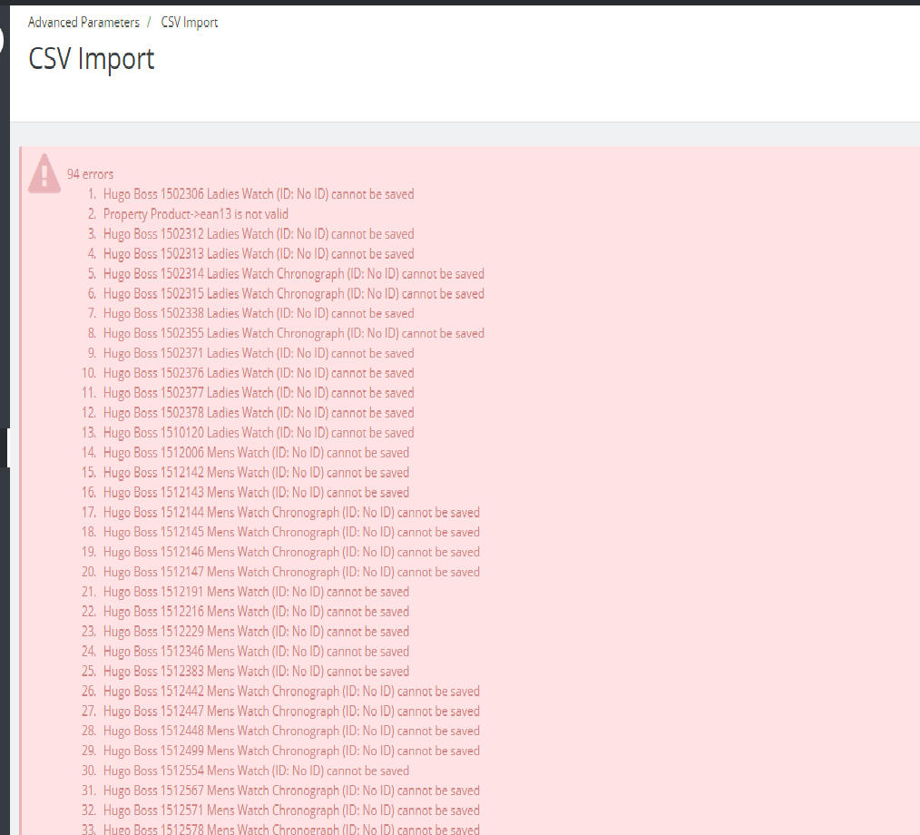

oscarw Posted December 8, 2015 Author Share Posted December 8, 2015 Okay now I managed to load the first 100 files in the file. Then I tried to load the next 100 files in its own file, and then I get the following error Link to comment Share on other sites More sharing options...
RogueWaveLimited Posted December 8, 2015 Share Posted December 8, 2015 Is the formatting different between the two files? Different delimiter etc? And you meant "100 rows" when you said "100 files"? You can attach the file that worked and the file that didn't and I'll take a look. 1 Link to comment Share on other sites More sharing options...
