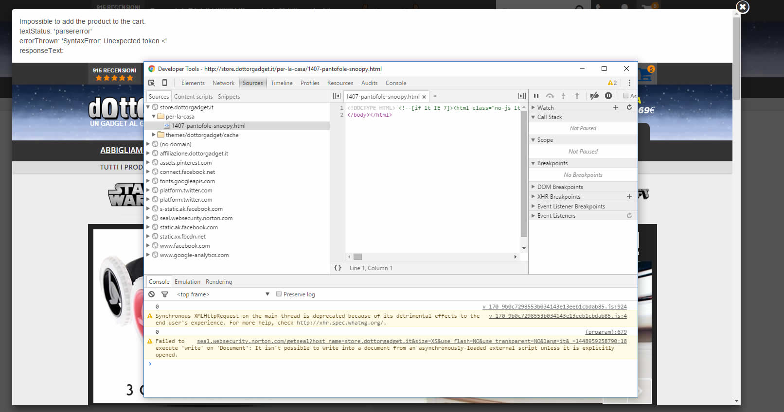

When the error showed I tried inspecting code with chrome but I didn't found any error notify.
Trying to make some test I just found a products that gives me that error, and inspecting the code with developer tools of chrome i see from the console these error:
Synchronous XMLHttpRequest on the main thread is deprecated because of its detrimental effects to the end user's experience. For more help, check http://xhr.spec.whatwg.org/.          v_170_9b0c7298553b034143e13eeb1cbdab85.js:4
seal.websecurity.norton.com/getseal?host_name=store.dottorgadget.it&size=XS&use_flash=NO&use_transparent=NO&lang=it&_=1448707271475:18 Failed to execute 'write' on 'Document': It isn't possible to write into a document from an asynchronously-loaded external script unless it is explicitly opened.
The strange things it's that if I retry the same products on another browser or the same browser but another computer this error it's not showed, so it seem that this happen only sometimes.

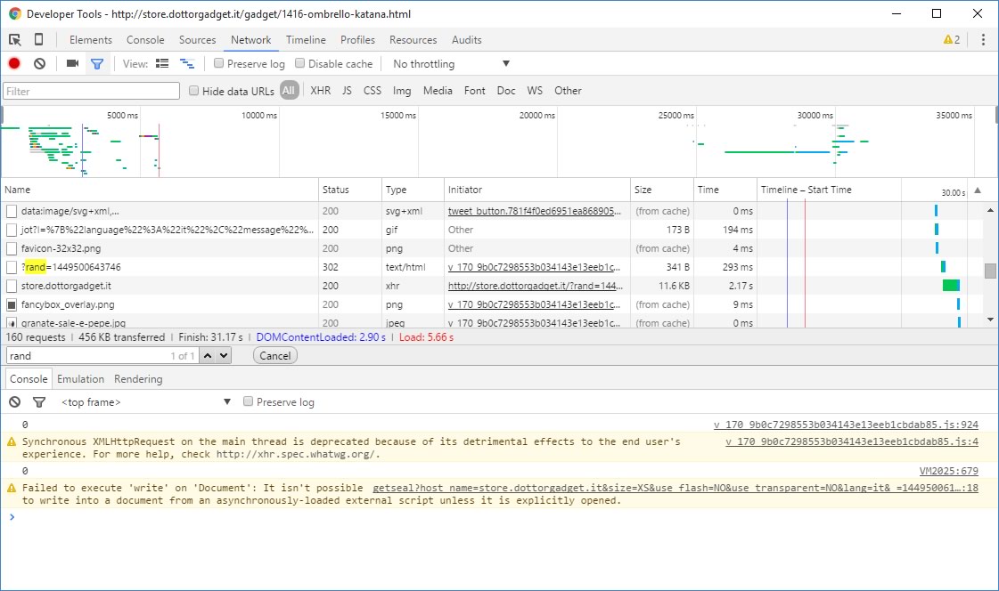

See in the top tabs list, left of the tab you clicked? Network. Hit that, then the last entry should be what I mentioned :) If the response is blank turn on error reporting, but it seems like it's a badly formatted one
Ok maybe i found what you asked, see the image below.
Edited by DARKF3D3 (see edit history)
On headers tab it show:
Request URL:http://store.dottorgadget.it/?rand=1449678271592
Request Method:POST
Status Code:302 Moved Temporarily
Remote Address:176.227.172.113:80
Response Headers
view source
Connection:keep-alive
Content-Encoding:gzip
Content-Length:20
Content-Type:text/html; charset=utf-8
Date:Wed, 09 Dec 2015 16:24:48 GMT
Location:http://store.dottorgadget.it/
Server:nginx
Vary:Accept-Encoding
X-Powered-By:PleskLin
X-Powered-By:PHP/5.4.45
X-Robots-Tag:noindex, nofollow
Request Headers
view source
Accept:application/json, text/javascript, */*; q=0.01
Accept-Encoding:gzip, deflate
Accept-Language:it-IT,it;q=0.8,en-US;q=0.6,en;q=0.4
AlexaToolbar-ALX_NS_PH:AlexaToolbar/alxg-3.3
cache-control:no-cache
Content-Length:92
Content-Type:application/x-www-form-urlencoded; charset=UTF-8
Cookie:PAPVisitorId=cde9f2c0ea499e58b7cdfbd05a10Cg2R; expresscache_advcachemgmt=0; _ga=GA1.2.1451882102.1447857926; PrestaShop-a30a9934ef476d11b6cc3c983616e364=GjxC9Q9Nn1siWqlMIKNOhe5dYqyabAlzx8rG7BJAdaiJYDWpgthXN9wY3JaN%2BImqc3ZgV0%2F5%2FJbdUa2tuiioR3eeYU%2FePPgYbWO0mYSnJTHXPp7WQ6EOoEgFGTxF%2FzL33XWU1WRSvABwt8VCaIFE98zmyiA8d0X2V6sgRbdOzQhBI3ke%2Bx%2FdHy2i3dgoguABraLy15puaPnPeXuoxkHrZdFWCqGghal%2BuUerhDnILN12faPMZlRVjxFHqALwVQ7KVGB3rZ%2BoSuhI9j0oKW0zH5qTDV6dC4vyeuJsLnnZ0jshi6VbjvhAlAe2A0XvjQ%2F0qeMKiBGUJKGkwiFDSCSJAQWAz7uUveglYuwYNH%2FU4y7sfoQA681OiiPNmb3xtURQQEYJ3bqXMuVk00jlT8SY%2BgbC0D1ypK2ZfbqdfIEKCVP863dM0BHdcDkCEHxeSORxzFTUvizsyPnlsdQL2AdqUsV224q4FsvBBjHkrCVrFIKvhlQVMoDj%2Fiy8KyhtaF%2FsS8Q1rb5oeTePL7F9hqTCbA4p7HCtg%2B2n2t6lOp3nRrsQX9rZ6mqoNUSHACnbJ7%2F8HXtl2lle%2Bs3J6CBIiplYYzrsJkU%2FNy0KK9uqxXz4Brw10UBaZYULXz0a4pVUyaMx%2B9%2FS%2F4Y1Qu6ButVWViW6r%2FFrrkYz4TEmC%2BJ5wfMyAss3snnPtPqj0pEHnr9phfzZKdCMVhrAe3FG6fgYdJuiT%2BOfs3mmXYBp9o8TAb1Q%2Ft51T01PjkQ3gzaSomHtTTjL1XbHPBNBzZFChx2hNnVrp70WNM2hQZTiSPPoRg1kyqHcBpYwuRRv2Q4IKLx%2FjqvLB5fMwOe21OaLTEq4uu5p4eSIW5RpHBvwdJ%2BpLmkXdz0nic0r%2Bwq4zgBO%2FpCeIeE6rlj5sRAWIEsnUy2chsRnau2s6HMw3Osj3QCd%2BD1HHfJzVdKm30WChS%2FhjkmzG4HQh%2Bx%2FZML2O0kfPjDleIgwIf7GukDKXixhl6umF2jVU5JaxexxCKCrnbrxIkOuHf2K5YniACHejr9JAQp3cU2HkpqU4NFuEXzM5vrx2fX44TsWoaw%2BQUnDDHOd7%2FqO3J2u2saOtMTuo2Z8znpHWeAmgvd5FgOnv0y%2FBukR0mdbBiLhOypeNyvDRyWpPTfBDIj4KhJE5zW476a9QrGWEhmye4mlMO1XjiSJ6SEkf61nQGrgf2C0B0Ho8BjIrzCWOQJgCa7A7bQlIFU2KbOneKiaIY1EIcwbMP0EzyvXQzyUMU2vtpm5zBIuSrg14%2FZhsKFHcGgnle3PwqPCm6FWC1Jb73vQGA9pwAPCyU6YEEgBovRDL3WZwcQdm%2FhQrt6Pl%2Bcjdst9rsOfIwQ87vM37Yzyc6%2BdF2azZVkkF96%2B%2F8gXuIn7dtTj2uPhz2xOHa24Yvmh6H3314g1T51PJLInXALGhj0BH%2F9rwUykS2AnQyZ7Pv%2F3PLGlqjcAERSVIHx50KN5NI%2BUs89vxR848KllmpmP45FRkMdNTkhjgylye%2BH1uXv3LLWmYi84M8RqF3upuIaGngv3mR5YZBViq%2Fo0KOp2NQXKaeqkxKNwW3BakkhFRKFKwkTnbcgQj9mI7b%2FBu7X6h%2BxlP7uLZkA%2F4is4ezo5x8GAax01C0mm41Cp%2F1phvhYbImiqrKkMVfBTiNJypYXZM3%2B3K%2FFnru2So11wfOR4EcJR8lrkCEnDavQ7GPi1Kaggs%2BydHzPMwHwhqJASUqXBhAzQWsH5VdeKIXs65oZAhZAFu2kI4eFWarcMwgpOmHRUZAV5Z3Ct0afMbrmFi4QgH8OKMANrZ1jdLvjS2EJGKK7xU862QnZO69QQ48yVkMHxylIg9v99MvZjtCAE1cBGqQcD6dEhPvwguIRNuF4ZUanuM00A8tIOGHURw3dHGSHhr18RNcv5rvulvB0kOUvTb47eO80tz%2FLUXjX1hDbL9%2FSWPGwaSjrO6Hazryrk%2Bq3f208mjCQZRVa0s%2B%2Fzxf3tpJcuUxT9JcXyMzq%2BiHlOQXcC%2Bh%2BDQQflGKdApug5PXR%2BuFejN6q1Sf7GueX3sLHoOdq11%2F0LicYuTURShdeC8HpY1QWCfTudI4j5bpjwUER1coa9L8KeXVA29MPlzoIdY1Txz3OI2s7Xnt5bxrQnIrQmMOxEnMN4W%2BxZMCpckMc0XOD8E4Y9VGtqPb%2BICUUp%2Fp2a1G65ycuX6UbuDNvYwCIyxdU7K4Esy46sLXDOI3UiW3KCYY1vTEVDVaZCPiAMai477vZlp4D%2FU3tlw145O2hnPGh9jZtHqMYfaQXXFnK9Pg9pF%2FKRHshEBTvFWK3k001725; PAPVisitorId=cde9f2c0ea499e58b7cdfbd05a10Cg2R; PrestaShop-8730dbe8cb8c89b4bd5ad3c237dab30d=GjxC9Q9Nn1siWqlMIKNOhdhrvF09rmx13Kf84tNxTHb%2FeJkqxJfycC71nNj6i4oET8NKbJvfROsGue%2B0wXIszynbizsRsAnIigswTbfzF7jhv75BiI5crSvTFL4O92BXlJPctZoYy6We%2FLb0Ramw4VzrO1P6XxBH5z71oP2CQFZT%2BqqjNSojypHHe1xe6oXRx0oJavhv90d7MwETN5ZNF16pHlAux7o8eLe0ckqRTN%2FqOS4g%2Bik7vj%2FJMUWtQb15Q9jIQavQOI57kJ8a0RYPCXfS2axkgMhUJR75p6PGb1cVsU%2FRkYszfrQrpkDUA1atWGz1y1%2FcLAB9cLrL9qmO3VILVdiujq2GZSU4vGJOcu535jjLW19OfZsgwv7%2B%2FVikFqHzhaq7zjLHKZY2shXJpV0EH6jsTdwnahwk3t7eVB775OUoc3SAlvt4GQTAAybtf7Z9aJZ4KqXXmrQxIQhzYouu9lC163fauYjyHOd%2B0%2F3e0OGtUtMCHtDR6G3rNkBCycFuKAC4w%2BRedugv04FJITAgivfe6fxoAD2pdahSnij0r4WT0fgKVWN6IzF1iEE1DPac258SOa9BxkJwfR6Koqm8lfzC%2Fc5KBZpqWxoxjDeAh6FKQxS3nyId2bCoPBpAtUxOsSUSgNxAQuBJg5eFy56jZ2f1Xa1Pb4KJ8uZ%2FfY74AmyAFYanGlw74BieMBqG0%2Bk%2BX1jVC3Kl5GIlwoUu9pk%2FDxUB%2BLUM3%2F2f0menyGoVbKLR4WFM0wPOICXUMgBJq1dnO%2Bh8q2A1ZNdcvMwkAE%2BULEsiwYH%2BVfJPn9MXD0rGvnw3VISAI48jxmaDODk2Vs0QUfMDmsET6okntUOWbUa2gEgI4dwPo5v4YNJOlRFPeoXP0DjK%2F%2F%2FbkyNH2ax2quTi%2BOv4oLwOa92dybyFrETW6mUHB4maN372Z2StpenPpsicLI3IoZMBv2iYDocPWMNdGsouZLcgE%2BQ9VFi7LLgprl96knqSRqTqWGe6WZ8EO0i%2FmMJ7dnj1cEgc3WBMjtHgFz7sHHNexD8ufk6tDO7Fn49mA%2FMopMgEMygO4M3OZA1cafj8cqOfJ2QBfowm3NY0y0S341bL7s8O7kS5%2BN1a%2BxCL2zOYXnOM%2BOtb1D89t9hUpKaieHzGoc6BJPfntBmw59kWXcImNl3mzmUV08ACo9V5LLKUeeucPu4H%2FTO9zRZFH2XAVL3roOLk4icyKBf1JSz4Ur0%2FbAowMl%2BuewVBwb2G21yDwuo4pURKeps%3D000940; __utmt=1; __utma=163638013.1422308558.1447853666.1449671086.1449678267.163; __utmb=163638013.3.10.1449678267; __utmc=163638013; __utmz=163638013.1448841513.90.17.utmcsr=blog|utmccn=banner-natale-2015|utmcmd=sidebar-bottom-star-wars
Host:store.dottorgadget.it
Origin:http://store.dottorgadget.it
Referer:http://store.dottorgadget.it/gadget/1416-ombrello-katana.html
User-Agent:Mozilla/5.0 (Windows NT 10.0; WOW64) AppleWebKit/537.36 (KHTML, like Gecko) Chrome/47.0.2526.73 Safari/537.36
X-Requested-With:XMLHttpRequest
Query String Parameters
view source
view URL encoded
rand:1449678271592
Form Data
view source
view URL encoded
controller:cart
add:1
ajax:true
qty:1
id_product:1416
token:c475256cf792981dae00c788bfb91ea2
