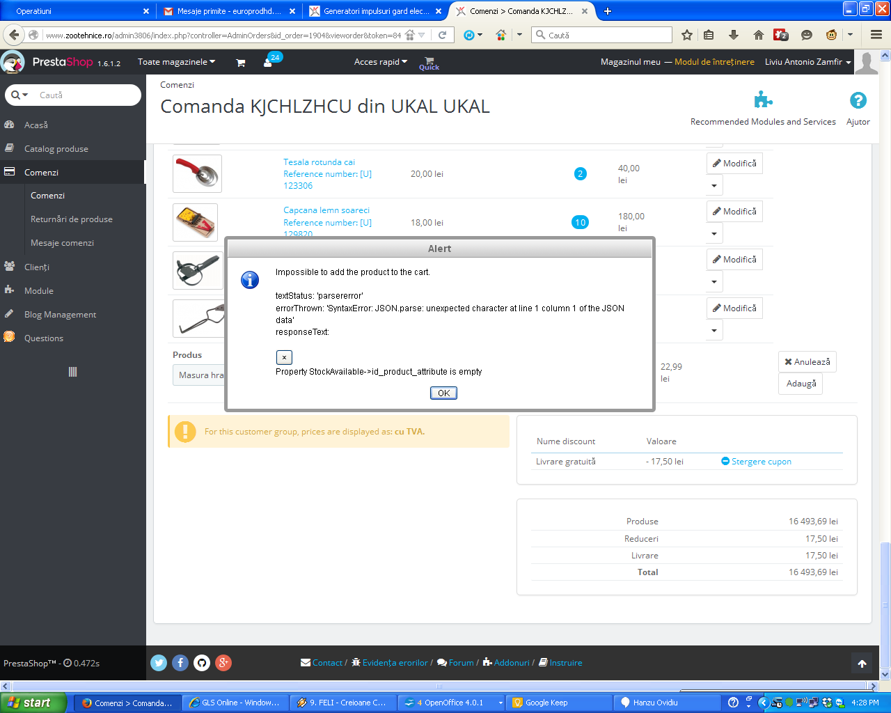

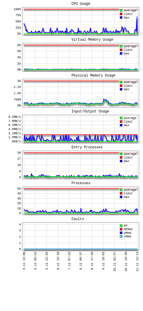

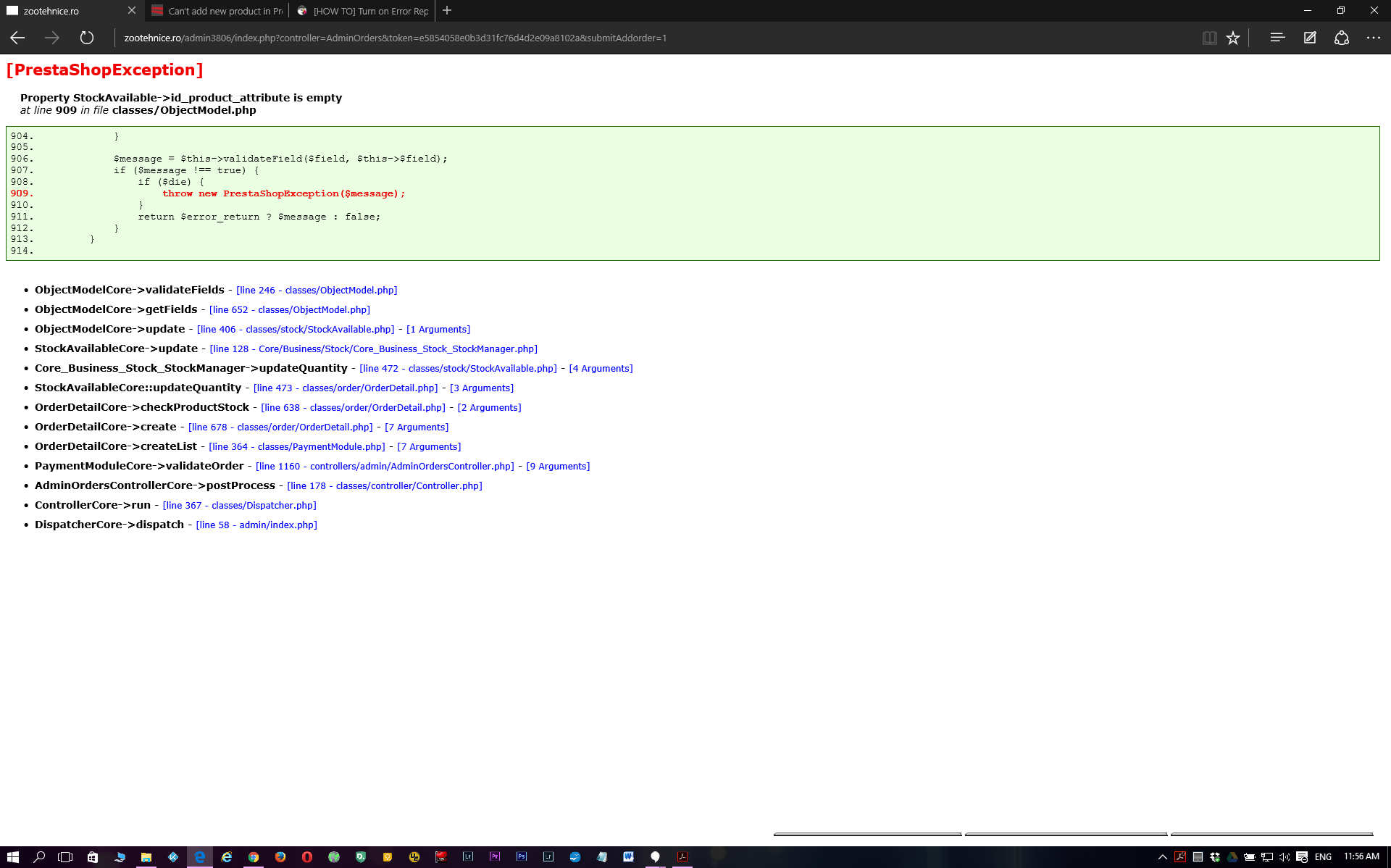

Ovidiu H Posted November 12, 2015 Share Posted November 12, 2015 Hello. I want to let you know that we have some problem whit the new update of Prestashop 1.6.1.2. 1. When a client place an order, we can not see the products in the order only the client information, but no products. We have enabled the debugg mode and this error appear "Stock Available id_product_attribute is empty" Please see attachement Screenshot 2015-11-11 11.56.27.png 2. When we try to add a product to an existing order we get the same error ( "Stock Available id_product_attribute is empty" ) but not every time. Please see attachement Screenshot 2015-11-11 16.28.09.png 3. Sometime our Prestashop generate a hight I/O usage, I do not know if this can affect te functionality. Please see attachement Livechart.png If someone has any ideea how to fix this, please let me know. Thank you, very much! Link to comment Share on other sites More sharing options...

tomas.stancl Posted December 19, 2015 Share Posted December 19, 2015 Hi, I have the same problem. It make error 505 in last step of order. Do you have solution for this? LOG: *ERROR* 2015/12/18 - 15:25:16: Property StockAvailable->id_product_attribute is empty at line 909 in file classes/ObjectModel.php Thank you. Link to comment Share on other sites More sharing options...
Ovidiu H Posted December 22, 2015 Author Share Posted December 22, 2015 Our problem was fixed by someone that we work whit. The problem was in the ps_stock_available table in database. Some records were missing after we made the upgrade to Prestashop 1.6.1.2. Our guy has created a script (stock_available_fix.php) to find and restore missing records. The number of records in the table are 2741 vs 2002 before the fix. I believe the problem was rather related to old products with ID < 700. I hope that this can help you. 1 Link to comment Share on other sites More sharing options...
Sashok Posted February 3, 2016 Share Posted February 3, 2016 On 12/19/2015 at 11:02 AM, tomas.stancl said: Hi, I have the same problem. It make error 505 in last step of order. Do you have solution for this? LOG: *ERROR* 2015/12/18 - 15:25:16: Property StockAvailable->id_product_attribute is empty at line 909 in file classes/ObjectModel.php Thank you. It is a bug in file Core/Business/Stock/Core_Business_Stock_StockManager.php at line 126 you should have like this: $stockAvailable->quantity = $stockAvailable->quantity + $delta_quantity; $stockAvailable->id_product = (int)$product->id; $stockAvailable->id_product_attribute = (int)$id_product_attribute; $stockAvailable->update(); 4 Link to comment Share on other sites More sharing options...

chafox Posted December 12, 2016 Share Posted December 12, 2016 No script needed, just as Sashok said : It is a bug in file Core/Business/Stock/Core_Business_Stock_StockManager.php at line 126 you should have like this:$stockAvailable->quantity = $stockAvailable->quantity + $delta_quantity;$stockAvailable->id_product = (int)$product->id;$stockAvailable->id_product_attribute = (int)$id_product_attribute;$stockAvailable->update(); It worked fine for me, Charlotte 3 Link to comment Share on other sites More sharing options...
AmirRzd Posted April 19, 2017 Share Posted April 19, 2017 On 2/3/2016 at 1:46 AM, Sashok said: It is a bug in file Core/Business/Stock/Core_Business_Stock_StockManager.php at line 126 you should have like this: $stockAvailable->quantity = $stockAvailable->quantity + $delta_quantity; $stockAvailable->id_product = (int)$product->id; $stockAvailable->id_product_attribute = (int)$id_product_attribute; $stockAvailable->update(); Thank you. It worked for me too (PrestaShop 1.6.1.5). Link to comment Share on other sites More sharing options...
