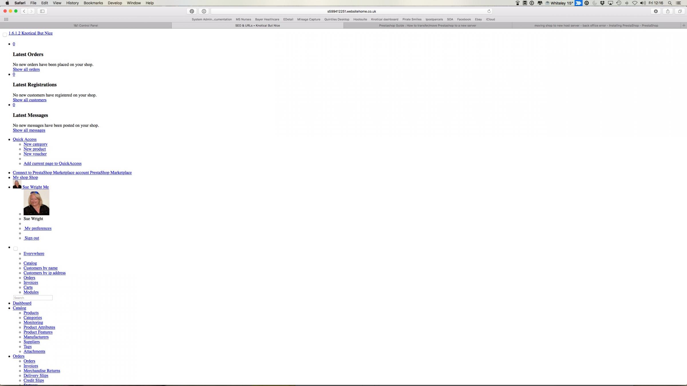

suewright Posted November 6, 2015 Author Share Posted November 6, 2015 (edited) have you tried to remove the .htaccess file in the knoticalbutnice folder? deleted .htaccess Have followed to the letter the instructions in the prestashop doc for moving onto a new server. error messages have gone but still only getting white screen with the writing on see attached Edited November 6, 2015 by suewright (see edit history) Link to comment Share on other sites More sharing options...
DigitalTitan Posted November 6, 2015 Share Posted November 6, 2015 I had a similar issue when moving my site to a local instance. What I did was going to Preferences --> Images --> REGENERATE THUMBNAILS. This may be an issue since you can't really see the images. But I clicked on your link, and it seems that you have a problem with the location and the path it is using. You wouldn't happen to be moving from a Linux to Windows environment or vice versa? The big clue for me is the error on the top of the page: Warning: mysqli::mysqli(): (HY000/2002): No such file or directory in /homepages/3/d599412247/htdocs/knoticalbutnice/modules/wpintops/wpintops.php on line 139 Maybe the module didn't make it over. I'm not quite sure, but hopefully this helped? Rob Link to comment Share on other sites More sharing options...

pedepot Posted November 7, 2015 Share Posted November 7, 2015 Hi, Long time ago, I remember that this issue happened to me and nothing changed after I made all the settings you did so far. Your host does not see your files, for example http://s599412251.websitehome.co.uk/themes/default-bootstrap/cache/v_28_5ea0ea1730ec20a33731325ac8889061_all.css doesn't work. Please reset your cache. Go to Admin > Advanced parameters > Performance and select the option "Force compilation" . I hope it help! Link to comment Share on other sites More sharing options...
