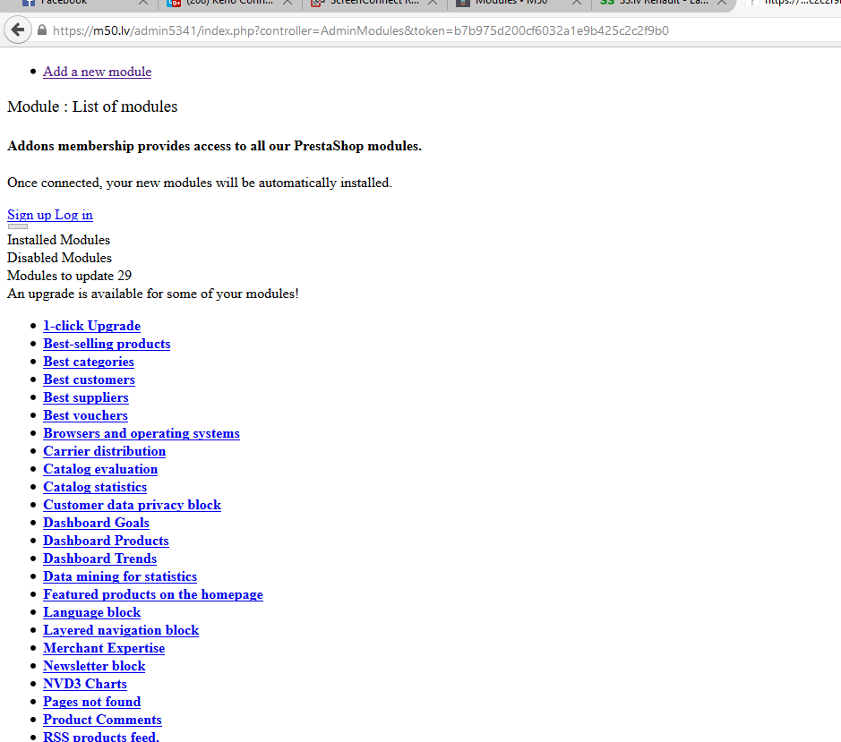

edmundspriede Posted October 29, 2015 Share Posted October 29, 2015 good day after manual upgrade to 1.6 controller AdminModules is not working properly. it does not include <head> section in code, so all css and js is missing. looks like it outputs only content portion. all other modules and frontend is ok, no errors on server. i did upgrade on local workstation and then copied to server, locally no problems... any suggestions? Link to comment Share on other sites More sharing options...
tuk66 Posted October 29, 2015 Share Posted October 29, 2015 (Temporarily) remove folders one-by-one from /modules and test. Link to comment Share on other sites More sharing options...
edmundspriede Posted October 29, 2015 Author Share Posted October 29, 2015 did not help, removed all modules.... do not want a clean reinstall yet. cleaned all caches , no help. if i copy all files locally i did catch this problem locally , tried to debug but then it disapeared, so it must be cache related Link to comment Share on other sites More sharing options...
tuk66 Posted October 29, 2015 Share Posted October 29, 2015 It can be server related. Link to comment Share on other sites More sharing options...
edmundspriede Posted October 29, 2015 Author Share Posted October 29, 2015 there was this file here. deleting it solved the problem. no idea how it got there /httpdocs/admin5341/themes/default/template/controllers/modules/header.tpl Link to comment Share on other sites More sharing options...
