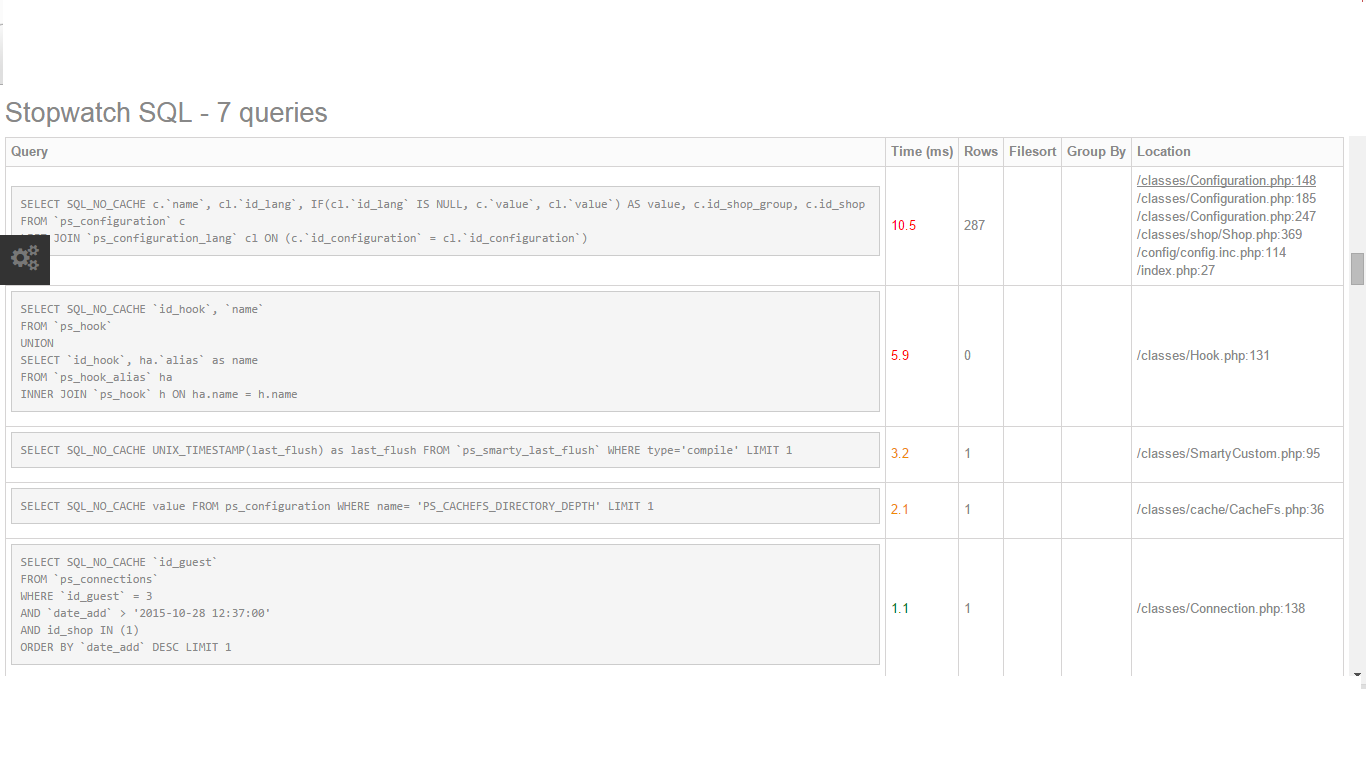

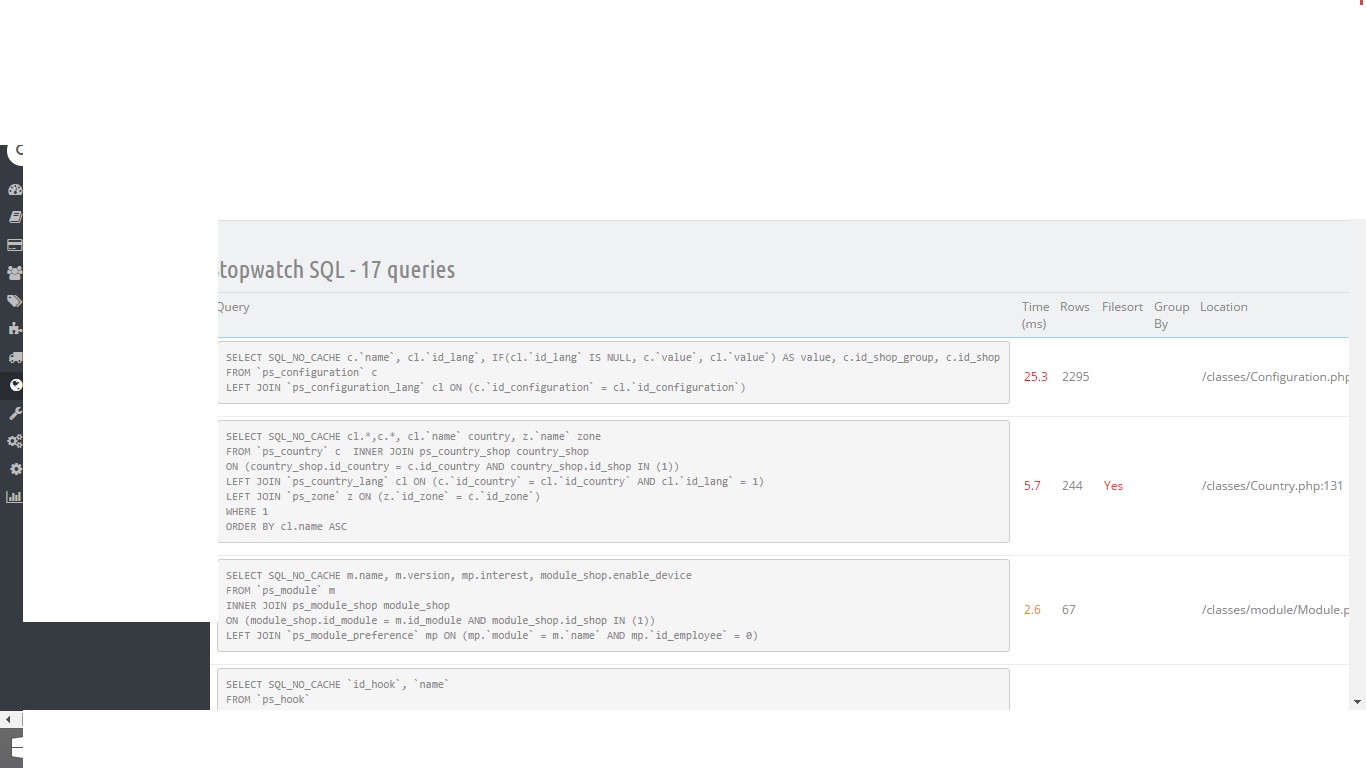

mrtommy Posted October 28, 2015 Share Posted October 28, 2015 HiI had similar problem once and I solved it by first check what is happening with load times. My site took between 10 sec to 45 sec to load after going from "internal" to live shop, before that it was still slow with load times of 4 sec but I didnt fully realized that then... first enable boleean in PS_DEBUG_PROFILING in config/definde.inc.php to "true" then go to site and reload page and see what is happening, what is taken so long? I'll bet you have a host issue with too less memory dedicated We had 96MB and that wasnt enough for 40K customers and 14K products in database and typhicall 5-20 visitors at the same time in shop When upgrading to 512MB the site went really fast and the problem was gone 1 Link to comment Share on other sites More sharing options...
soares Posted October 28, 2015 Author Share Posted October 28, 2015 If that happened it means your mySQL server is not on the same server. You should use the IP that points to your database. If you are getting 10 second delays with a stock install, then you must be having a problem with your mySQL server. I'm using the server name, the ip server I cannot find it HiI had similar problem once and I solved it by first check what is happening with load times. My site took between 10 sec to 45 sec to load after going from "internal" to live shop, before that it was still slow with load times of 4 sec but I didnt fully realized that then... first enable boleean in PS_DEBUG_PROFILING in config/definde.inc.php to "true" then go to site and reload page and see what is happening, what is taken so long? I'll bet you have a host issue with too less memory dedicated We had 96MB and that wasnt enough for 40K customers and 14K products in database and typhicall 5-20 visitors at the same time in shop When upgrading to 512MB the site went really fast and the problem was gone I've already did it but then I do not know what to do with the information. I guess my memory is ok. My database for know is quite small, it should not be the problem, at least with the memory. Link to comment Share on other sites More sharing options...
