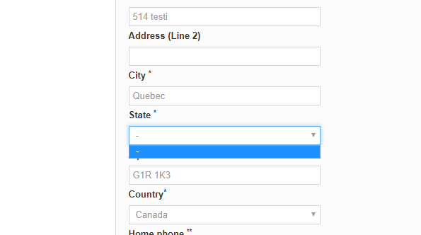

innercode Posted June 3, 2016 Share Posted June 3, 2016 Ordering to US is fine, but there is a bug with ordering to Canada. It is set that Canada contains states but for some reason it disappears when changing to Canada. ZIP code is ok, except its field validation (frontend part). Entering correct ZIP, it marks with red X that it is not correct, but it passes validation on submit. We can help you with this issue, if you wish, write us PM or send us an email. Link to comment Share on other sites More sharing options...
peggy king Posted June 3, 2016 Share Posted June 3, 2016 if this "Red X" th ing is a bug, why hasn't prestashop fixed it. I'm pretty sure I'm loosing sales here. And I've seen other posts about it. Link to comment Share on other sites More sharing options...
