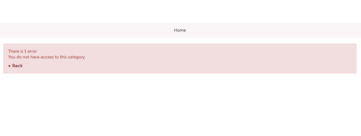

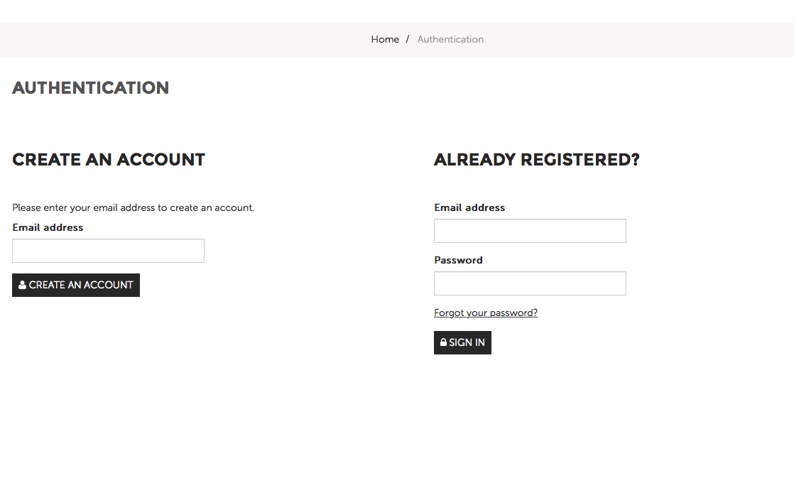

adriano.matos Posted October 22, 2015 Share Posted October 22, 2015 Hello PrestaShop world! We have some items that we want to put in the “outlet” area. I already found out how to put that “area” reserved to registered costumers. But it gives an error and i wanted to edited the message so it can show other information / redirect to the login page. For now, i could only limit the access to the category. But i wanted to redirect to the login page. How to explain: we wanted that when the costumer goes to the “outlet” area, only persons with account can see. So, when someone clicks on “outlet”, they receive a message saying “you need to login to access this category” and shows the login area. There is a screenshot to the "error"/message that shows now. And an image of what i wanted to show when clicking on a "customer only" area. How can we do this? Any thoughts? Best regards! Link to comment Share on other sites More sharing options...
