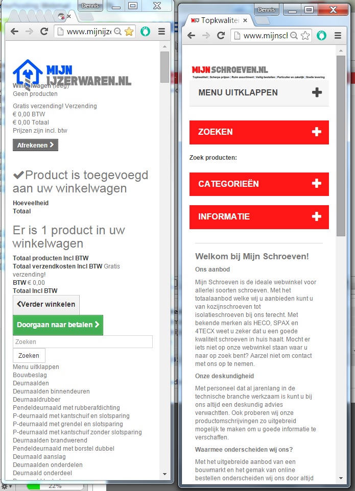

Dennasz1 Posted October 15, 2015 Share Posted October 15, 2015 (edited) Hello, I have multistore in prestashop version 1.6.0.9 and i am having problems with the mobile theme on one of my sites. The mobile theme looks like there is no style used on cart and category module I have attached a picture of the problem and a a picture of my subsite which works well with mobile theme. All of the websites are quite the same with modules/positions/settings. URL= http://www.mijnijzerwaren.nl Every help is appreciated, Dennis Edited October 29, 2015 by Dennasz1 (see edit history) Link to comment Share on other sites More sharing options...

Dennasz1 Posted October 21, 2015 Author Share Posted October 21, 2015 Hello Antropy thanks for your reply. It looks like there is no style of the cart and category block in the mobile theme. This problem occures sometimes when a module is not hooked to the header. In my case the modules are hooked to the header and it works fine on computer screen. So i don't really know a solution for the mobile version. Dennis Link to comment Share on other sites More sharing options...

Dennasz1 Posted October 22, 2015 Author Share Posted October 22, 2015 Yes! That is indeed the problem. Compare it with my other site www.mijnschroeven.nl.. that one works well Link to comment Share on other sites More sharing options...
Dennasz1 Posted October 22, 2015 Author Share Posted October 22, 2015 Hmm yeah.. its definitely something with the styles cause the shopping cart is also wrong displayed. I think it's nog a big issue to solve but i can't find it for now. Thanks for looking in to it! Link to comment Share on other sites More sharing options...

Dennasz1 Posted October 29, 2015 Author Share Posted October 29, 2015 Hi Antropy. I did not make any big changes in my code files according to the default theme or whatsoever o i still think it's just a setting. Link to comment Share on other sites More sharing options...
Dennasz1 Posted October 29, 2015 Author Share Posted October 29, 2015 Yeah, finally solved it! https://www.prestashop.com/forums/topic/262692-solved-problem-with-mobile-theme-non-responsive/ I turned off Smart cache for JavaScript and set use "Cached Mode" to off It's strange cause my other sites have these settings ON and they do work. Anyway i don't know if this is the good solution but it works Link to comment Share on other sites More sharing options...
