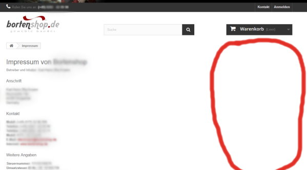

Zeitfalle Posted October 10, 2015 Author Share Posted October 10, 2015 Hallo Whiley, vielen Dank! Genau das meinte ich!!! Link to comment Share on other sites More sharing options...
