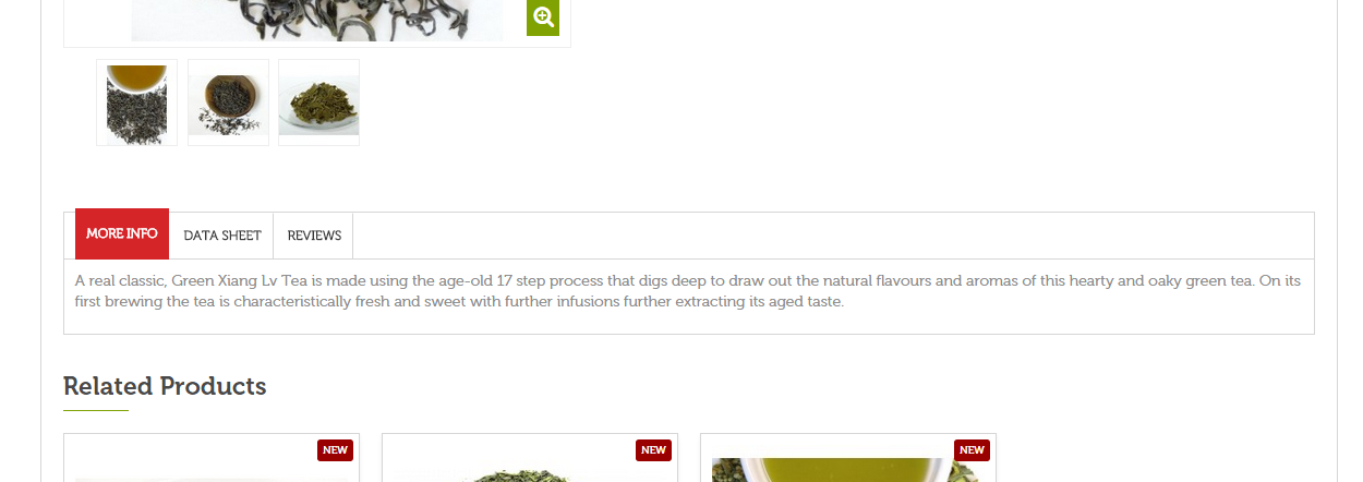

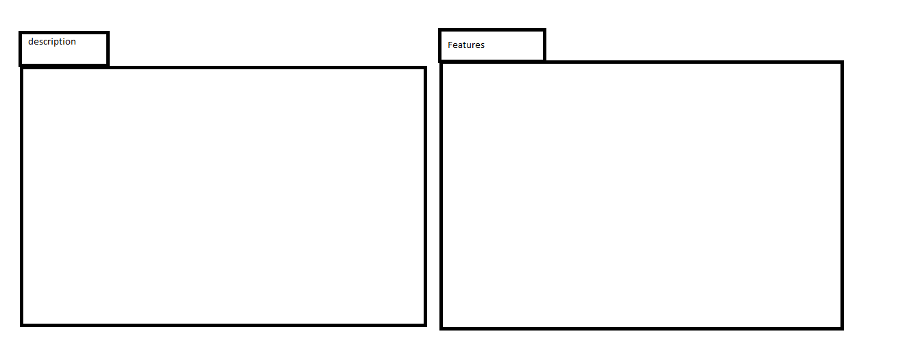

MrPandaPants Posted September 29, 2015 Share Posted September 29, 2015 Hi, I'm using version 1.6.1.0 and I would like to turn off the product tab and product feature that are listed when a visitor sees the unique page for each product. I would instead like to have the description and features to be listed in two separate boxes. Is there an easy method to achieve this. I can provide further information to assist finding a solution. Link to comment Share on other sites More sharing options...

MrPandaPants Posted September 30, 2015 Author Share Posted September 30, 2015 Thanks for taking the time to reply. I can't provide a link as I don't wish to publicise the site and it's in maintenance mode. I have attached two images of what I'm seeing. I hope this helps to explain my issue. Link to comment Share on other sites More sharing options...
NemoPS Posted October 2, 2015 Share Posted October 2, 2015 You'll have to do some custom coding. It' hard to point you since we can't see the html, but generally you want to check product.tpl, where it lists the tab (might be more_info_tabs) and take the corresponding tabs and sheets out of, and into another block, below that. Then just use css to set these main boxes to 50% width and float:left Link to comment Share on other sites More sharing options...
