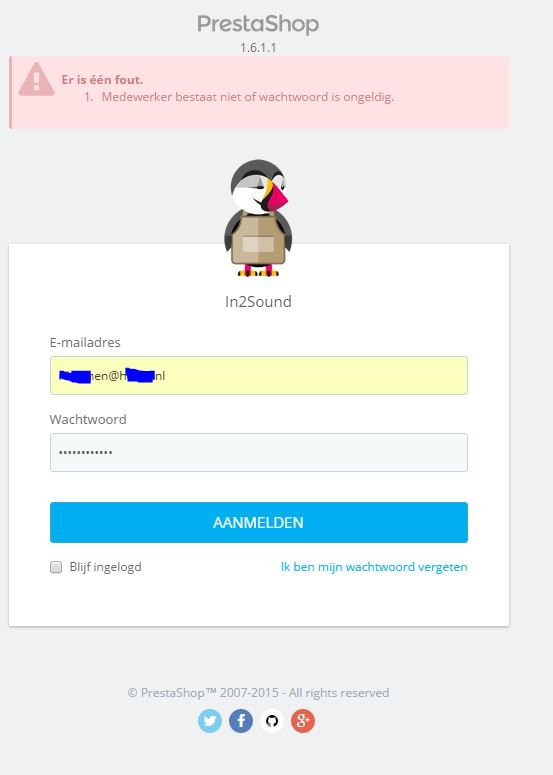

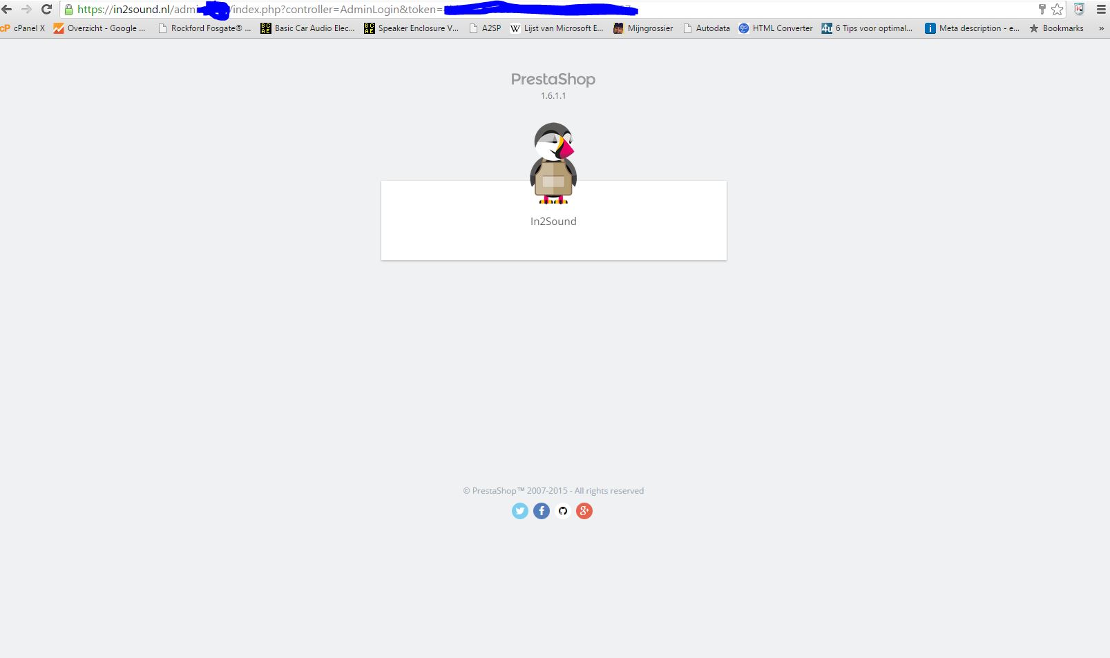

René Kuenen Posted September 19, 2015 Share Posted September 19, 2015 (edited) Hello, I have upgraded from 1.5.6.3 to 1.6.1.1 and now I cannot login to the BO. The front office gives me the 500 Internal server error in stead of the maintenance page. Before upgrade I did empty cache, database optimization. Server performance = Low Disable non-native modules = Yes Upgrade the "default" theme = Yes Upgrade the default e-mails = No I get the login screen and when I input the credentials the screen removes the login and password bar and stays that way. If I input wrong credentials it gives me the normal screen with the comment for wrong credentials. (see attachments) I turned on Debug in defines.inc.php, not error what so ever. What should I do to resolve this problem? Thanks in advance. Regards René Edited September 19, 2015 by René Kuenen (see edit history) Link to comment Share on other sites More sharing options...
