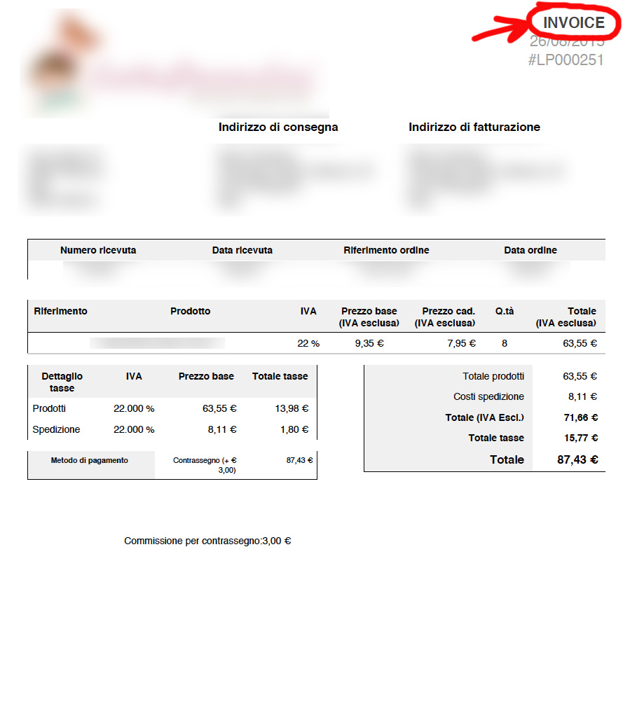

eikon13 Posted August 31, 2015 Share Posted August 31, 2015 Salve, sto cercando di modificare il termine INVOICE che esce in testa al documento PDF della fattura. Non emettendo fattura, vorrei cambiarlo in RICEVUTA. Nelle traduzioni ho trovato tutto il resto e sono quindi riuscito a modificare le voci dei campi interni, ma quello in cima, a inizio documento, no... qualcuno sa dirmi dove lo pesco? Grazie! Link to comment Share on other sites More sharing options...
tuk66 Posted August 31, 2015 Share Posted August 31, 2015 Qual è la vostra versione? Si tratta di un bug in 1.6.1.0, fissato in 1.6.1.1. What is your version? It is a bug in 1.6.1.0, fixed in 1.6.1.1. Link to comment Share on other sites More sharing options...
eikon13 Posted August 31, 2015 Author Share Posted August 31, 2015 Hi - 1.6.1.0. I just found your answer to the problem on another post and got to solve it https://www.prestashop.com/forums/topic/452236-pdf-invoice-title-cannot-be-translated-after-update-to-1610/ So if I upgrade to 1.6.1.1 that problem should be fixed anyway? Would I be safe upgrading...? Link to comment Share on other sites More sharing options...
tuk66 Posted August 31, 2015 Share Posted August 31, 2015 I would suggest to upgrade, but test it carefully first. Link to comment Share on other sites More sharing options...
Giorgio M. Posted August 31, 2015 Share Posted August 31, 2015 Se aggiorni alla 1.6.1.1 lo troverai direttamente nelle traduzioni. Altrimenti dovresti andarlo a correggere a mano vai CLASSES -> PDF e correggi il file HTMLTemplateInvoice.php Link to comment Share on other sites More sharing options...
