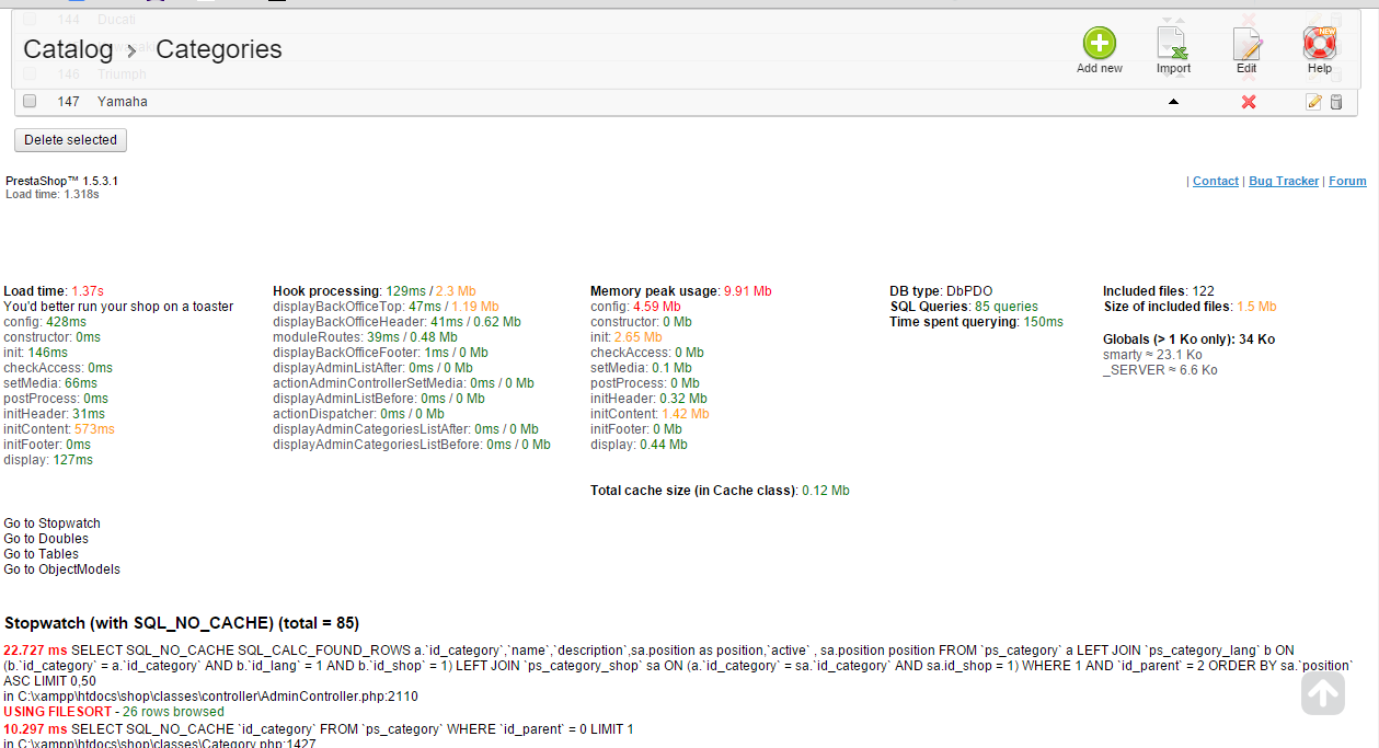

mickeyboy1 Posted August 29, 2015 Author Share Posted August 29, 2015 All this is done on localhost so live site is safe I set debug on both sites and went into admin then categories tab just for comparison and screenshot them Results... 153 site has lots of categories and products yet 1.6.1.1 site is fresh clean install so cant understand why its slower 1 Link to comment Share on other sites More sharing options...

El Patron Posted August 30, 2015 Share Posted August 30, 2015 All this is done on localhost so live site is safe I set debug on both sites and went into admin then categories tab just for comparison and screenshot them Results... 153.png 161.png 153 site has lots of categories and products yet 1.6.1.1 site is fresh clean install so cant understand why its slower I'd put up in a subdomain in target hosting to get better feel....localhost as you know is not giving you end results. for 1.5...if you want fast front office take a look at the 'rather' famous module I wrote for 1.5. This only helps front office, but the is a related on I did for bo. https://www.prestashop.com/forums/topic/314461-module-javapro-prestashop-performance-significantly-speed-up-your-shop-pages-defer-javascript/ Link to comment Share on other sites More sharing options...

mickeyboy1 Posted August 30, 2015 Author Share Posted August 30, 2015 Hey, I just want to add my input here. Maybe it helps. First of all you can't compare a live server with a localhost one. You misunderstood my arguement.... Both of these sites i have put images up for are both running on localhost And as you can see the 1.5.3 loaded with categories and products site loads faster than an empty fresh 1.6.1.1 version So as they are both on localhost i would expect the newer empty version to be faster than an older version with lots of products Link to comment Share on other sites More sharing options...
