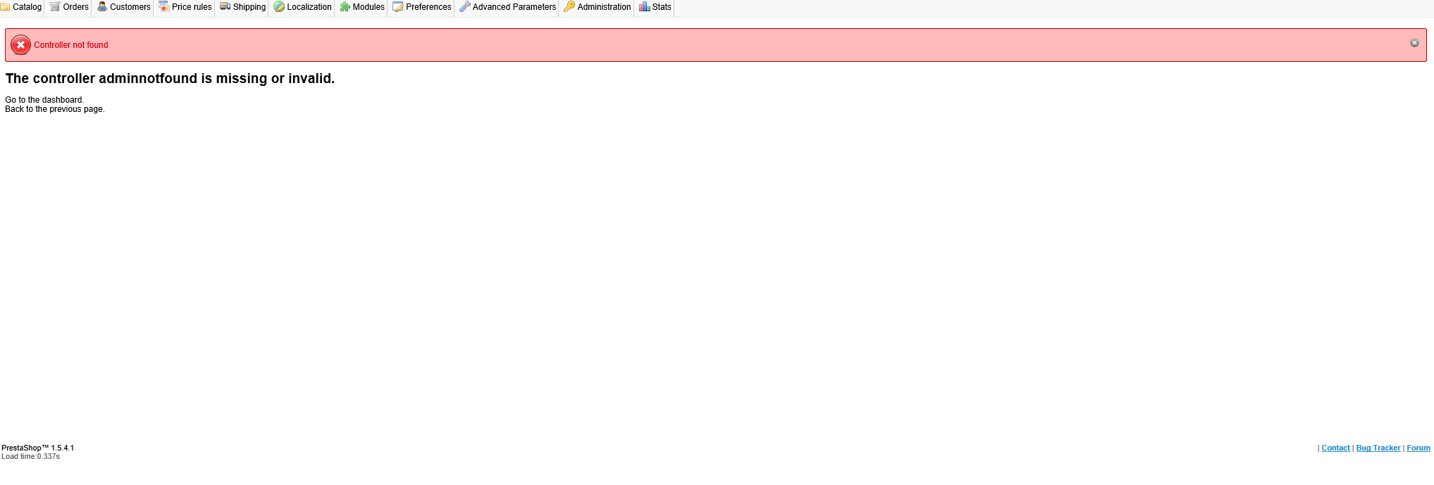

wilfred11 Posted August 27, 2015 Share Posted August 27, 2015 Hi all, I wonder if anyone can help me with this issue: I am helping a client upgrade from 1.5.4.1 to the latest version. To be safe we got a new domain, I backed up the database, downloaded all files via ftp and uploaded them again to the new domain. The idea being to test the upgrade on a different copy before going for it in the main domain I duplicated the database on a new database and amended the config>setting.inc.php to the new database details. All this went fine. Everything is good on the new domain copy apart from when I go to the modules tab I get the following: "The controller adminnotfound is missing or invalid" Checking the controllers the file adminnotfoundcontroller.php IS there Looking at the error I can see this when I look at the above file... Fatal error: Class 'AdminController' not found in /****/*****/**/*****/html/modofficefurniture/controllers/admin/AdminNotFoundController.php on line 28 The file referred to in the above looks like this... * International Registered Trademark & Property of PrestaShop SA */ class AdminNotFoundControllerCore extends AdminController { public function checkAccess() { return true; } public function viewAccess() { return true; } public function initContent() { $this->errors[] = Tools::displayError('Controller not found'); $tpl_vars['controller'] = Tools::getvalue('controller'); $this->context->smarty->assign($tpl_vars); parent::initContent(); } } It looks correct to me... I am a little stumped here and the only other thing I have found is that the file cache/controllers/AdminModulesController.php did not seem to be in place and when I try to upload it via ftp it immediately disappears. Obviously I need to be able to see the modules on the back office but I have reached a dead end. Can anyone help? - Best wishes : Dom Link to comment Share on other sites More sharing options...

wilfred11 Posted September 3, 2015 Author Share Posted September 3, 2015 As an update I have copied all files again from the old domain to the new domain and as soon as I click on the modules tab the following appears (see image). I have checked through all the controllers and they all match so really not sure what I am missing here.. any help would be appreciated. Best wishes : Dom Link to comment Share on other sites More sharing options...
wilfred11 Posted September 3, 2015 Author Share Posted September 3, 2015 Hi guys, I seem to have isolated what might be the issue. The two files AdminAttachmentsController.php and AdminModulesController.php upload to the server ok but on refresh they just disappear !... I have tried renaming them and uploading to a test folder on the site which is at the top level but the same happens, poof, as soon as I refresh the files have vanished. This would certainly seem to be a clue as to the above and I have seen this mentioned elsewhere without being resolved. Anyone got any ideas? Many thanks : Dom Link to comment Share on other sites More sharing options...
wilfred11 Posted September 4, 2015 Author Share Posted September 4, 2015 Just to update, I eventually managed to get these files up by using the hosts own file management system rather than ftp and then I got a 500 error which on debugging was caused by the fianetfraud module. Reading the forum it appeared ok to delete this so after deleting bingo, we were all on and ready to test the upgrade. Many thanks: Dom Link to comment Share on other sites More sharing options...
