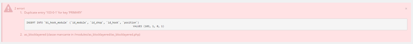

I'm posting this question since this is only happening in the upgraded site, not in the original site. I did everything according to the suggestion here in the forum: I made an exact replica of the original ecommerce (not without some troubles) and I started the update.
I fixed some issues:
  • defines.inc.php corrupted and replaced with the original one from the 'clean' distribution
  • removed the modules that caused problems loading
  • resolved the id_product_2 issue, according to the solution provided by the forum
  • fixed original template porting issues (deleting the rows from the php files)
And i got a working wordpress at 1.6.1.1. I even placed an order.
But.
When I try to switch to any template (the main reason I tried to update my site) I got the error in attachment, stating I'm trying to insert a duplicate into the database.
What am I doing wrong? It appears the single theme isn't the problem (I got the same issue changing to the default bootstrap theme). I tried removing all non-prestashop modules, since it seems to be connected to the installation of new modules.
I read is difficult to revert the site to a 'clean state', but is there a possibility to understand which hook causes the trouble and to skip it?
Thanks in advance for your time,
M.
Faithful to my recent attitude of solving my own problem and keeping a journal like the castaway movie in which I use this forum like a modern 'Wilson', I just realized that if I disabled one module (dashboard) on installing the template, everything seems fine.
Is it because of the module or because the place of that module in the database? Any clues?
