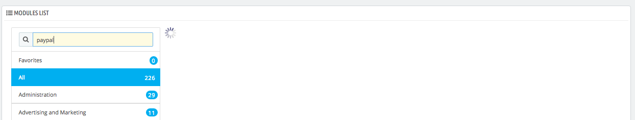

prestalearn Posted August 20, 2015 Share Posted August 20, 2015 I just upgraded my shop to 1.6.1.1 and on pages where the spinning wheel (for loading stuff) is located the spinning wheel never stops spinning. THis can be for example when searching for a module in module section or when payment options should be loaded in checkout. Does someone know what might be wrong? I Attach a screenshot of the thing to clarify. I really need help, thanks in advance! Link to comment Share on other sites More sharing options...

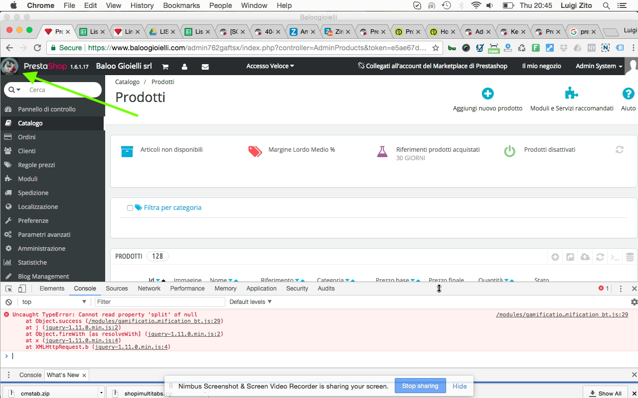

omine Posted August 30, 2015 Share Posted August 30, 2015 (edited) Normally, this happens after upgrade the platform. First thing to do is try to clear your browser cache. If not working, read the browser console according to @vekia instructions. I saw your screenshot but, you must post the screenshot of console tab. The tab on your screenshot is the network log, not the "console". Sample: Edited November 10, 2017 by omine misstype fix (see edit history) Link to comment Share on other sites More sharing options...

DiverseSolution Posted November 9, 2017 Share Posted November 9, 2017 Hi Guys, i found this thread that seems to be related with my problem as well . The parrot keep spinning all the time even if the page is completely loaded . This is only happen under catalog>products here the screenshot : Link to comment Share on other sites More sharing options...
omine Posted November 10, 2017 Share Posted November 10, 2017 @DiverseSolution, just press F5 on your brower. Did you tried the solutions above? Clear the browser cache, normally solve this issue. Link to comment Share on other sites More sharing options...
DiverseSolution Posted November 10, 2017 Share Posted November 10, 2017 @Omine i tried that and did not work . I checked in errror.log and i saw a module that gives problem with ajax code . I disabled that module and issued solved . thanks for your suggestion Link to comment Share on other sites More sharing options...
