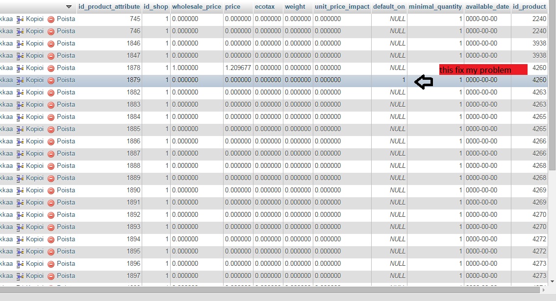

cille5 Posted October 24, 2015 Share Posted October 24, 2015 I found reason for my problem. After update prestashop 1.6.0.9 to 1.6.1.1 non of my products wich got compination doesen't got DEFAULT compination chosen. For example: Product got two compinations 1. Buy extra batteries 2. don't buy Non of these have't chosen default. I can chose default compination to product and then it will work right. Can I somehow do this to all my products from database? Link to comment Share on other sites More sharing options...
musicmaster Posted October 25, 2015 Share Posted October 25, 2015 This is set in the ps_product_attribute_shop table in the default_on field. I hope this information is enough for you to write a short PHP routine to do what you want. Link to comment Share on other sites More sharing options...
cille5 Posted October 25, 2015 Share Posted October 25, 2015 Thank you musicmaster. I have'to try and learn how to use database. What do you think should I make backup first? Link to comment Share on other sites More sharing options...
cille5 Posted October 25, 2015 Share Posted October 25, 2015 (edited) I found problem. Wich kind of command I should use to make every second row "null" to be number "1" See image attachment. Edited October 25, 2015 by cille5 (see edit history) Link to comment Share on other sites More sharing options...
musicmaster Posted October 25, 2015 Share Posted October 25, 2015 I am not that good in complex MySql command and prefer to solve it with a PHP script. In pseudo code it would be something like get all records from ps_product_attribute_shop ordered by id_product. foreach record set in the first record default_on to 1 and then skip the rest of records for that product. If you pm me the credentials for your phpmyadmin I could do it for you as it is rather simple. Of course you need to make a backup. It is easy to make some small error. As soon as you make some changes you should check whether things work correctly now - both in the database and in the shop itself. Link to comment Share on other sites More sharing options...
cille5 Posted October 26, 2015 Share Posted October 26, 2015 My problem is now solved. Thank to musicmaster. Link to comment Share on other sites More sharing options...
