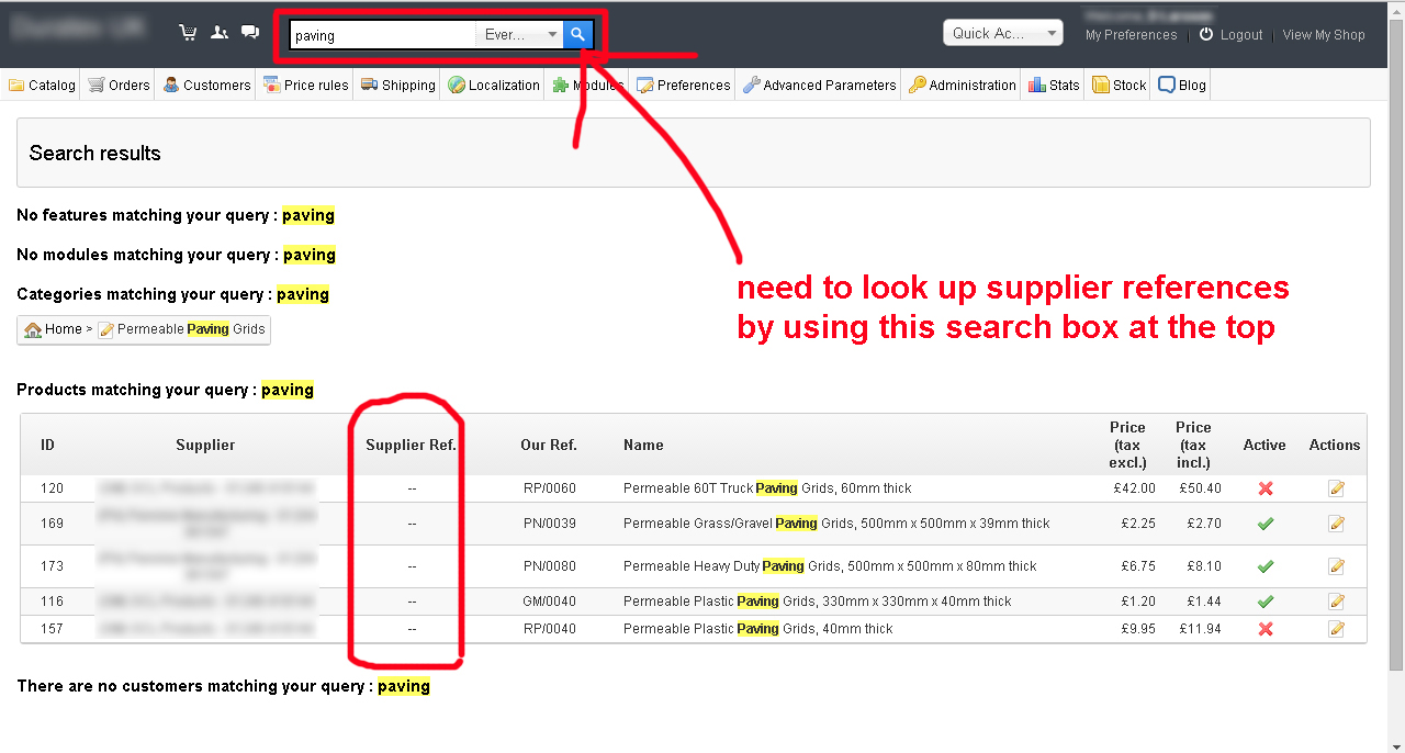

mowax Posted August 7, 2015 Share Posted August 7, 2015 (edited) Hi Really hope someone can help, been trying to figure this out for so long. I need to insert a column into the products table on the search results page (displayed when you search for a product in the search box in the top of the adminpanel). In the column I need to display the supplier's product reference for each product in the table. I have modified AdminSearchController.php and inserted the column, but I can't get the values to display. Please see the attached screenshot for clarification. I think I have to modify AdminProductsController.php to get the values to display but I have no idea how to do it. Any help would be really appreciated! Edited August 17, 2015 by mowax (see edit history) Link to comment Share on other sites More sharing options...

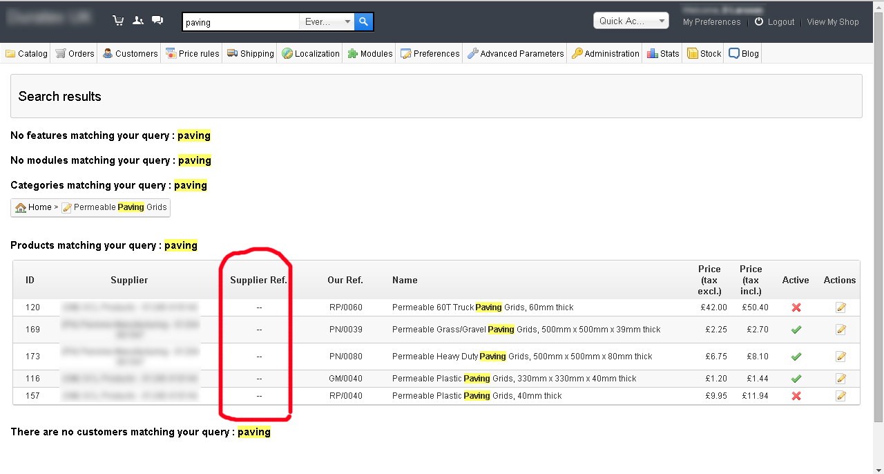

mowax Posted August 14, 2015 Author Share Posted August 14, 2015 Ok i just figured out how to add the supplier reference for products with combinations - in the ps_products_supplier table in the database, if the product has combinations it will always have a row in this table where the id_product_attribute value is 0, and if you input something in the product_supplier_reference field in this row, it will be displayed in the back office products list page. So that's great! However, I actually need this column in the admin search results page, that is displayed when you enter something in the search box at the very top of the BO page. Please see the attachment to see how I mean. Thanks for your patience Link to comment Share on other sites More sharing options...

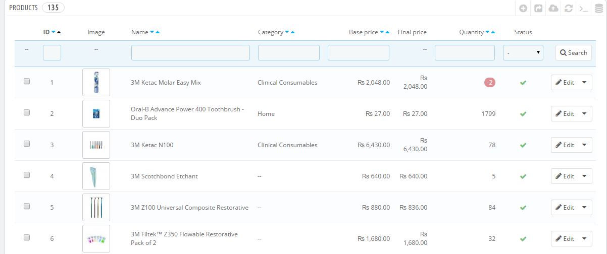

shakir.app Posted October 14, 2015 Share Posted October 14, 2015 (edited) how can i add two column namely ( supplier reference and supplier name ) in product list in presta shop 1.6 Edited October 14, 2015 by shakir.app (see edit history) Link to comment Share on other sites More sharing options...
