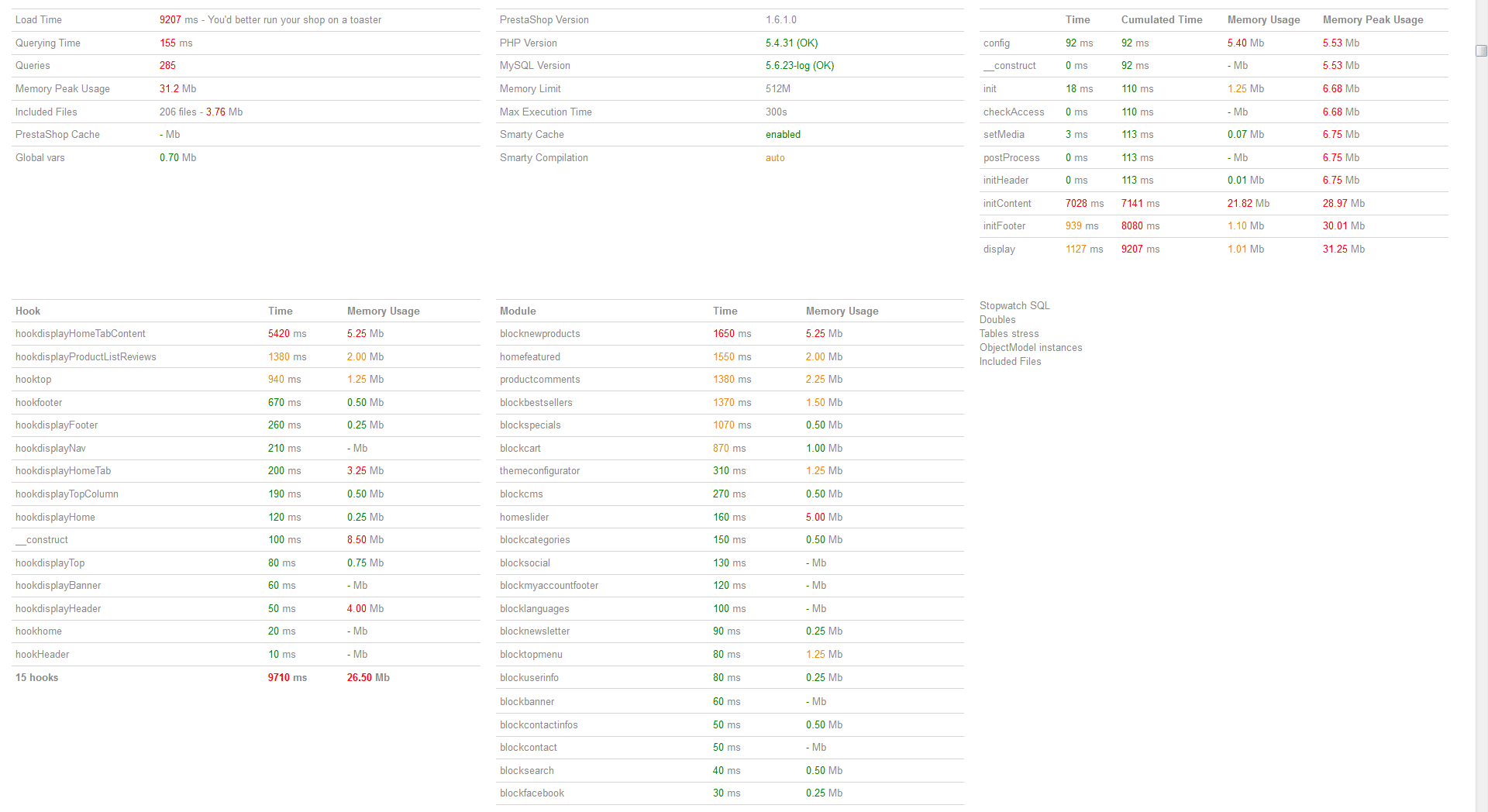

736Online Posted August 5, 2015 Share Posted August 5, 2015 I have found what I believe to be a pretty major bug in the latest software. And I have been able to duplicate this same issue on both a shared and VPS account. If you go into performance and click the Clear Cache button your website will slow to a crawl of 6-12 seconds with no other changes being made. I have tested this on a fresh install as well as on a test version stocked with stock on default themes and customs...all with the same result. I've also tried several combinations of settings as well as reuploading the cache folder in case the button broke some sort of write permissions and that failed as well. Has anyone else run into a problem with your site suddenly slowing down? This could be your cause as well! 1 Link to comment Share on other sites More sharing options...
736Online Posted August 6, 2015 Author Share Posted August 6, 2015 (edited) -Was not the answer to fix the issue Edited August 18, 2015 by 736Online (see edit history) 1 Link to comment Share on other sites More sharing options...
736Online Posted August 7, 2015 Author Share Posted August 7, 2015 This doesn't seem to be a long term fix, the issue keeps popping back up and never gets back down to the fast speeds. This error is still present on both VPS and shared hosting accounts. Link to comment Share on other sites More sharing options...

Mister Denial Posted August 18, 2015 Share Posted August 18, 2015 UPDATE: I just ran the debug tool on my slow PS 1.6.1 cleared cache test site, and noticed that all SQL queries start with "SELECT SQL_NO_CACHE" - desptie cache being enabled. Could that be part of the error? Link to comment Share on other sites More sharing options...
parsifal Posted August 18, 2015 Share Posted August 18, 2015 (edited) Isn't it possible that your finding about the queries is something normal when using the default Performance Options (Filesystem-based cache, instead of MySQL-based)? Unless the queries are different when compared to those in a fresh/before-clearing-the-cache installation... Edited August 18, 2015 by parsifal (see edit history) Link to comment Share on other sites More sharing options...
Mister Denial Posted August 18, 2015 Share Posted August 18, 2015 Isn't it possible that your finding about the queries is something normal when using the default Performance Options (Filesystem-based cache, instead of MySQL-based)? That is very well possible, I am no SQL expert. Just thought I'd point it out as possible cause for the slow queries. Something was changed between 1.6.0.14 and the latest 1.6.1, and that causes the cache clearing function in the BO to completely screw up the performance of the website. It looks like PS is compiling every page on every call, instead of caching them. Like smarty cache is not working at all. Link to comment Share on other sites More sharing options...
