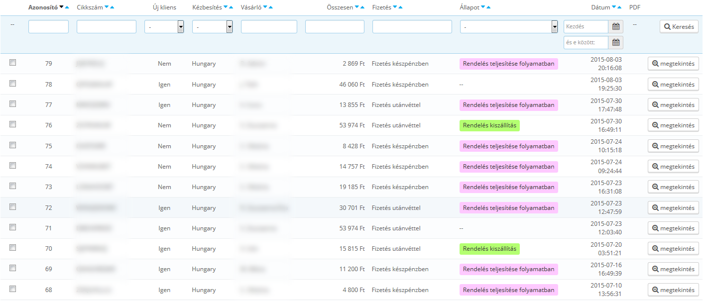

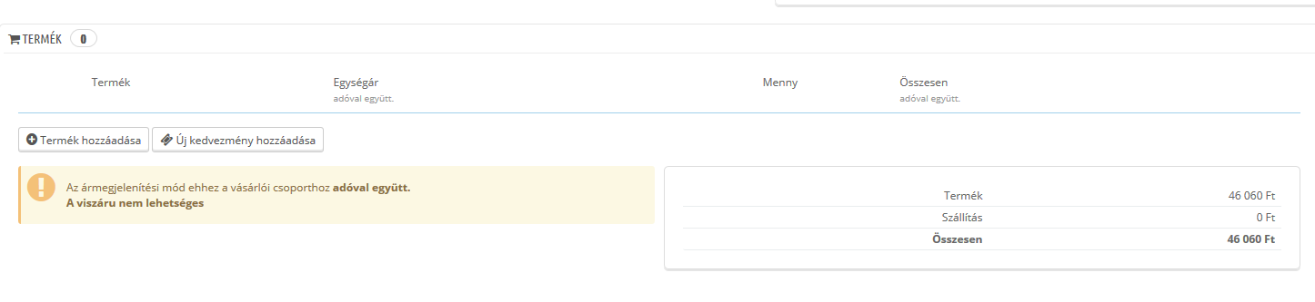

ikedubaku Posted August 3, 2015 Share Posted August 3, 2015 Hi! In BO sometimes when an order placed there isn't attached order status and also if I check that particular order, the products are missing. That means I don't get order confirmation mail and I believe customers also doesn't. If I ask the customer to reorder, everything going back to normal. This thing just started a few days a go. When I trying to recreate the issue for myself it's not happens. Below I attached a few picture from the problem, please help. PS version 1.6.0.11 I found only one relevant result, but that topic still unsolved: https://www.prestashop.com/forums/topic/382708-products-missing-from-order-page/?hl=%2Bproducts+%2Bmissing+%2Bfrom+%2Border 1 Link to comment Share on other sites More sharing options...

shopiemonte Posted August 21, 2015 Share Posted August 21, 2015 (edited) I had the same problem in last couple of days!On the db i noticed that the orders with this problem are missing the "ps_order_carries" and "ps_order_detail" rows The problem happend on 2 different orders, one payed with paypal and the other with credid card. PS version 1.6.0.14 Any idea of what is causing the problem? Edited August 21, 2015 by shopiemonte (see edit history) 1 Link to comment Share on other sites More sharing options...

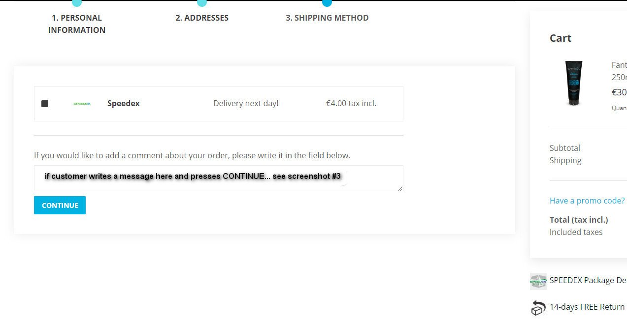

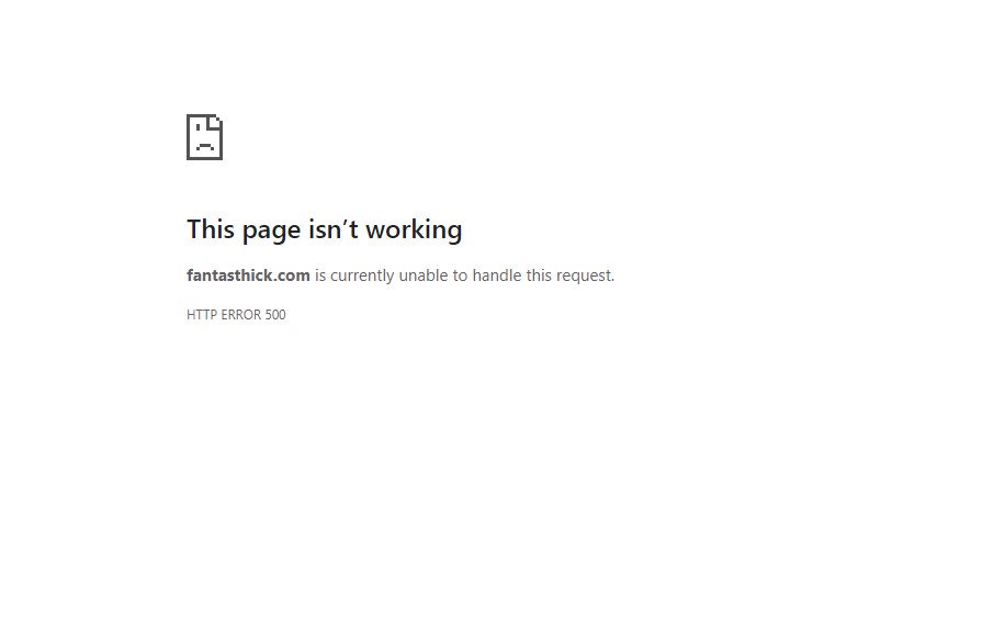

falcon030gr Posted December 18, 2019 Share Posted December 18, 2019 Guys, my setup: OS: Ubuntu 18.04.3 LTS Product: Plesk Obsidian 18.0.21 Prestashop version: 1.7.5.2 PHP version: 7.1.33 Theme: Template Monster theme by Zemez I am having the same issue (if I correctly understood). Customers that write a supplementary note at the shipping step of the order (e.g. "I will pickup from store", "please deliver it to my before Thursday" etc etc) get an error 500 and NO confirmation email is sent in the email they registered. Order can be seen only in the PS BO. This can happen in any of the payment options AS LONG AS the customer leaves an optional message at the SHIPPING METHOD screen. Next, you select the PAYMENT method, then comes an (optional) confirmation screen (depending on the payment method selected) and then BOOM! ERROR 500. The error comes immediately after choosing Bankwire, or in the case of COD or credit card purchase, it comes after the COD confirmation or when the customer is transferred back from the bank's safe environment, BEFORE the order confirmation screen that displays the registered order details to the customer. In any case, it must be the text inserted in the shipping step, that causes chaos and mayhem. Order has been placed but the customer doesn't know it. It can be seen only in the BO. Can somebody see what is going on and provide us with a patch or workaround? BTW, "hiding" the specific field doesn't qualify as a solution because customers usually have something extra to request as a final note. Please, I don't want to re-design the site in PS 1.6.xx. Come up with a solution or a recommended server setup! Thanks in advance, Peter Link to comment Share on other sites More sharing options...
selectshop.at Posted December 18, 2019 Share Posted December 18, 2019 This is very old topic, nevertheless the problem should be the same for all Prestashop versions: you are using a module or theme not compatible with the Prestashop version in use. Please disable all non-native modules and themes and try with native one. Re enable one per one for to check which one is making problems and then debug this one. If it is a non native thing, so you need to contact the developer. For 500 errors, these are server errors, you should additionally read the server error logs and debug them as well. Activate also the debug mode and read possible errors you are having and debug them as well. Link to comment Share on other sites More sharing options...
