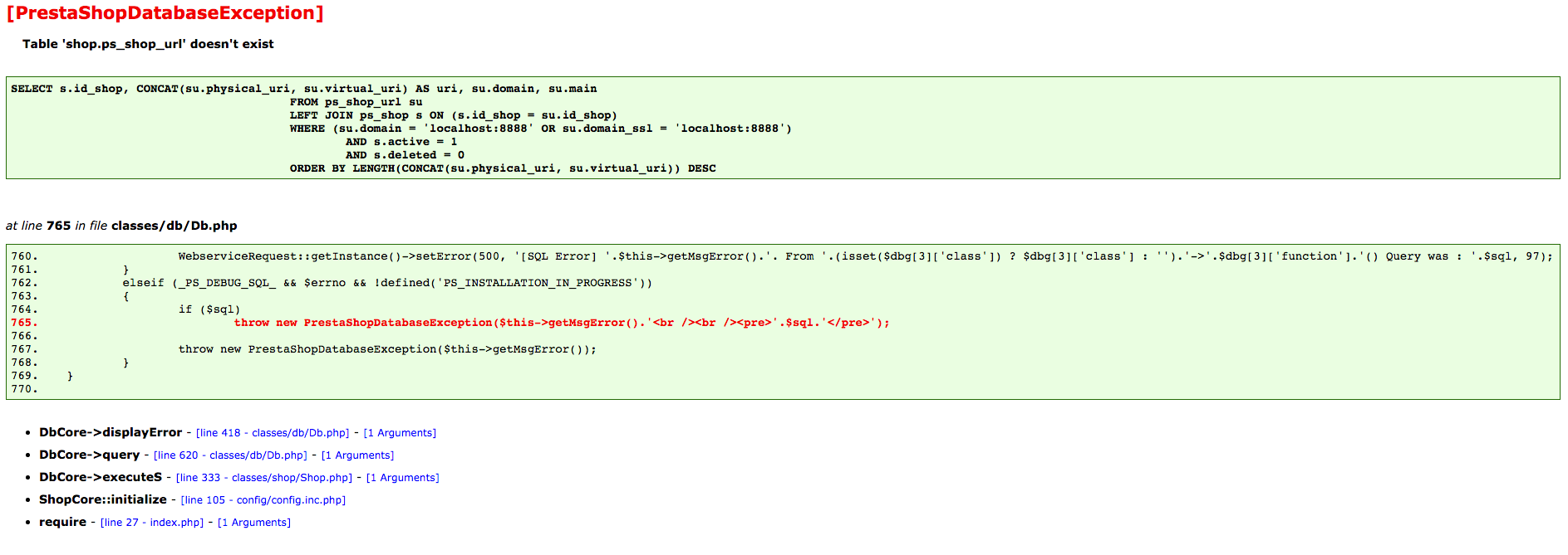

redmanjack Posted July 31, 2015 Share Posted July 31, 2015 Hi there, Can anyone help i've taken my website down to my localhost and have been trying to update from 1.4 to 1.6. I keep trying and i keep getting the same error!!!??? See below... Can anyone help, I've looked everywhere online and nothing i've found seems to fix it. I've used different step by step guides and ive googled the error but nothing! everytime the same error? [PrestaShopDatabaseException]Table 'shop.ps_shop_url' doesn't exist SELECT s.id_shop, CONCAT(su.physical_uri, su.virtual_uri) AS uri, su.domain, su.main FROM ps_shop_url su LEFT JOIN ps_shop s ON (s.id_shop = su.id_shop) WHERE (su.domain = 'localhost:8888' OR su.domain_ssl = 'localhost:8888') AND s.active = 1 AND s.deleted = 0 ORDER BY LENGTH(CONCAT(su.physical_uri, su.virtual_uri)) DESC at line 765 in file classes/db/Db.php 760. WebserviceRequest::getInstance()->setError(500, '[SQL Error] '.$this->getMsgError().'. From '.(isset($dbg[3]['class']) ? $dbg[3]['class'] : '').'->'.$dbg[3]['function'].'() Query was : '.$sql, 97);761. }762. elseif (_PS_DEBUG_SQL_ && $errno && !defined('PS_INSTALLATION_IN_PROGRESS'))763. {764. if ($sql)765. throw new PrestaShopDatabaseException($this->getMsgError().'<br /><br /><pre>'.$sql.'</pre>');766. 767. throw new PrestaShopDatabaseException($this->getMsgError());768. }769. }770. 1 Link to comment Share on other sites More sharing options...

Fabio Campanhol Posted August 23, 2018 Share Posted August 23, 2018 On 7/31/2015 at 9:38 AM, redmanjack said: Hi there, Can anyone help i've taken my website down to my localhost and have been trying to update from 1.4 to 1.6. I keep trying and i keep getting the same error!!!??? See below... Can anyone help, I've looked everywhere online and nothing i've found seems to fix it. I've used different step by step guides and ive googled the error but nothing! everytime the same error? [PrestaShopDatabaseException] Table 'shop.ps_shop_url' doesn't exist SELECT s.id_shop, CONCAT(su.physical_uri, su.virtual_uri) AS uri, su.domain, su.main FROM ps_shop_url su LEFT JOIN ps_shop s ON (s.id_shop = su.id_shop) WHERE (su.domain = 'localhost:8888' OR su.domain_ssl = 'localhost:8888') AND s.active = 1 AND s.deleted = 0 ORDER BY LENGTH(CONCAT(su.physical_uri, su.virtual_uri)) DESC at line 765 in file classes/db/Db.php 760. WebserviceRequest::getInstance()->setError(500, '[SQL Error] '.$this->getMsgError().'. From '.(isset($dbg[3]['class']) ? $dbg[3]['class'] : '').'->'.$dbg[3]['function'].'() Query was : '.$sql, 97);761. }762. elseif (_PS_DEBUG_SQL_ && $errno && !defined('PS_INSTALLATION_IN_PROGRESS'))763. {764. if ($sql)765. throw new PrestaShopDatabaseException($this->getMsgError().'<br /><br /><pre>'.$sql.'</pre>');766. 767. throw new PrestaShopDatabaseException($this->getMsgError());768. }769. }770. Expand I have the same problem, but at the time of new installation ... did anyone else have this same problem? Link to comment Share on other sites More sharing options...
Guest Posted August 27, 2018 Share Posted August 27, 2018 Maybe create the table and copy from working install? Link to comment Share on other sites More sharing options...
