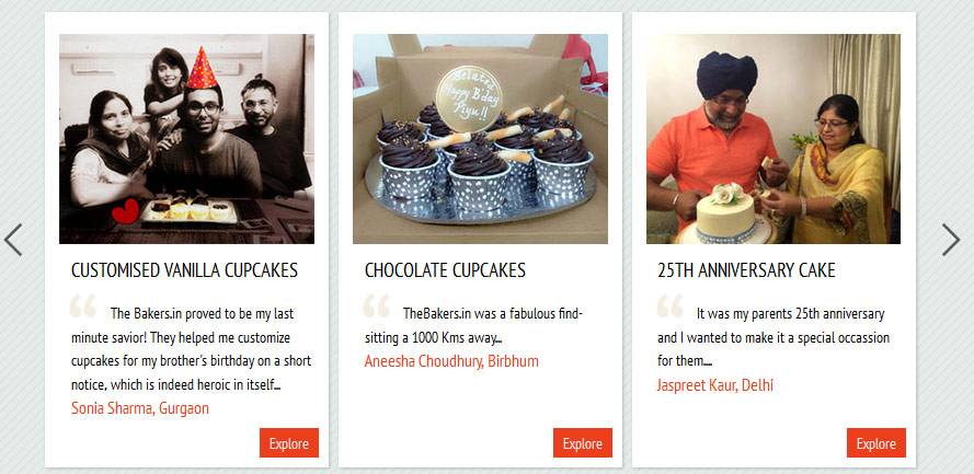

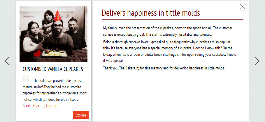

apatan Posted July 25, 2015 Share Posted July 25, 2015 Hi, I am trying to add a carousel on my home page. The code works absolutely fine on a stand alone html but when I try integrating as a module on the prestashop (ver 1.5.6), the links do not work. Can you please suggest, where I am making a mistake. I have spent the whole day today figuring this out but can't seem to make a headway Am attaching the screenshot as to who it should work but it doesn;t work when I test it as a prestashop module. Thank you for your help Cheers!!! <div class="ca-item ca-item-1"> <div class="ca-item-main"> <div class="ca-icon"><a href="#" class="ca-more"><img src="{$this_path}modules/blocktestimonials/img/abc.jpg"></a></div> <h3>Cupcakes</h3> <h4> <span class="ca-quote">“</span> <span>You proved to be my last minute savior! They helped me customize cupcakes for my brother's birthday on a short notice, which is indeed heroic in itself...</span> </h4> </div> <div class="ca-content-wrapper" > <div class="ca-content"> <h6>Delivers happiness in tittle molds</h6> <a href="#" class="ca-close">close</a> <div class="ca-content-text"> <p>My family loved the presentation of the cupcakes, down to the spoon and all. The customer service is exceptionally great. The staff is extremely hospitable and talented.</p> <p>Thank you for this memory and for delivering happiness in little molds. </p> </div> </div> </div> </div> Link to comment Share on other sites More sharing options...
