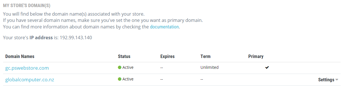

I'm setting up my store and linked one of my domain to the shop.
I have set the IP correctly and the management console showed it's ACTIVE
However whether it's www.XXX.COM or just XXXX.COM not, it only point to cloud console page, not actual webstore.
It only point to
https://www.prestashop.com/cloud/en/my-stores?init=listing
I have not made it as PRIMARY as I do not have plan to do it. Does it only redirect to the store if it set to PRIMAY? I have few domain names and I would like to all of them point to the webstore.
My domain to test is globalcomputer.co.nz / www.globalcomputer.co.nz
It should direct to gc.pswebstore.com not https://www.prestashop.com/cloud/en/my-stores?init=listing

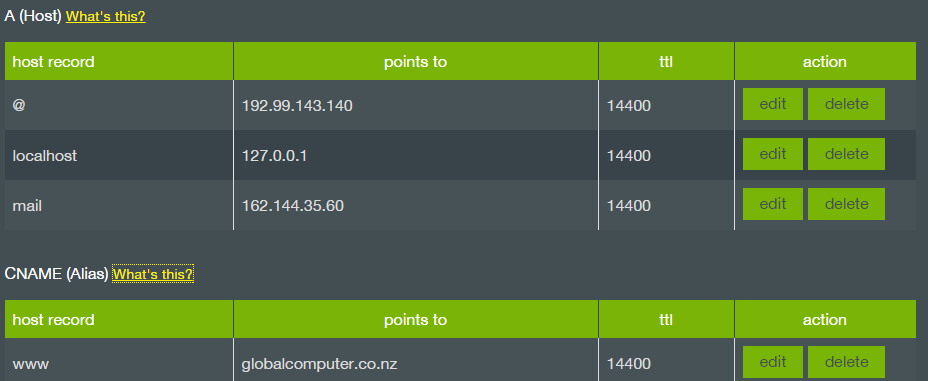

The Prestashop Cloud document said (http://doc.prestashop.com/display/CLOUD/Managing+domain+names#Managingdomainnames-AddinganexistingdomainnametoPrestaShopCloud)
"As the text explains, you have to configure the domain name's name server settings (or DNS)'s Type A record to point to the server's IP: 37.59.161.130 or 192.99.143.140 depending on your location. Follow the instructions on the screen, and within 24 to 72 hours, your store will be available on your domain from anywhere in the world.
Remember to have both example.org and www.example.org point to the server's IP, since they are two different addresses."
Which I understand that all I have to do is change A record of the zone of the given domain to 192.99.143.140 as shown on the picture.

My domain is hosted by Hostmonster and I have changed DNS record for A record to 192.99.143.140 as the instruction said.
However when I type www.globalcomputer.co.nz or globalcomputer.co.nz it goes to the prestashop cloud control panel not the actual webstore.
Which is same to happen when I type http://192.99.143.140 directly.
What I wonder is that Prestashop Cloud have a glitch that they should add the globalcomputer.co.nz / www.globalcomputer.co.nz on its virtual host list but didn't
Please correct me I'm wrong. The instruction clearly said to change A record of the DNS zone file, not change the DNS to the 192.99.143.140 . Afterall, when I NSLOOKUP 192.99.143.140 there is no record found for domain globalcomputer.co.nz

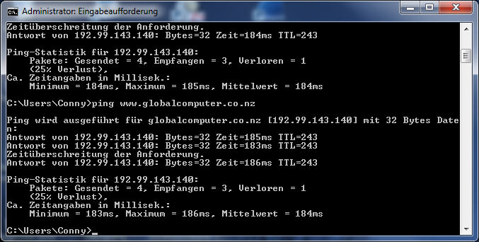

If Iping globalcomputer.co.nz (without www) and with www, I get the same error answer, although the domain is already pointing to Prestashop Cloud IP. Althoug the domian is redirected to Prestashop's Servers your domain is not answering properly (1 byte lost - 25% lost). You should contact your domain provider.  Something is going wrong on his DNS server.

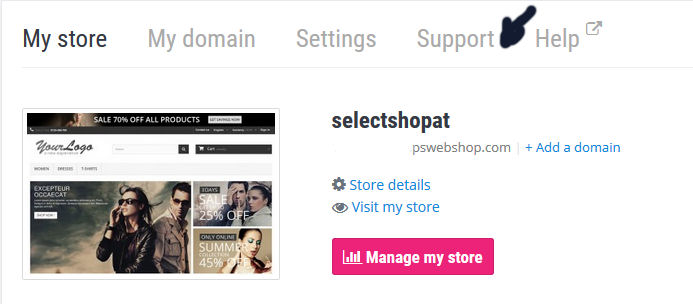

If your provider says that tests are passing his server, than you should use on the administration site of your cloud shop the tab "support" and ask for direct support by referencing to this thread.
