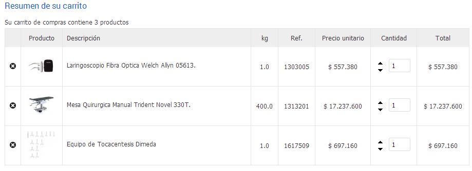

Jorge Vargas Posted June 6, 2013 Share Posted June 6, 2013 I have 1.5.4.1 version and I did this: shopping-cart.tpl <th class="cart_description item">{l s='Description'}</th> <th class="cart_ref item">{Configuration::get('PS_WEIGHT_UNIT')}</th> shopping-cart-product-line.tpl <td class="cart_description"> <div class="narrow-screen">{l s='Description'}</div> <div class="floatL"> <p class="s_title_block"><a href="{$link->getProductLink($product.id_product, $product.link_rewrite, $product.category, null, null, $product.id_shop, $product.id_product_attribute)|escape:'htmlall':'UTF-8'}">{$product.name|escape:'htmlall':'UTF-8'}</a></p> {if isset($product.attributes) && $product.attributes}<span class="cart_prod_descrip">{$product.attributes|escape:'htmlall':'UTF-8'}</span>{/if} </div> </td> <td class="cart_ref"> <div class="narrow-screen">{Configuration::get('PS_WEIGHT_UNIT')}</div> {if $product.weight}{$product.weight|escape:'htmlall':'UTF-8'|number_format:1}{/if} </td> Link to comment Share on other sites More sharing options...
atwitz3nd Posted June 15, 2013 Share Posted June 15, 2013 Hi On 6/6/2013 at 3:17 PM, Jorge Vargas said: I have 1.5.4.1 version and I did this: shopping-cart.tpl <th class="cart_description item">{l s='Description'}</th> <th class="cart_ref item">{Configuration::get('PS_WEIGHT_UNIT')}</th> shopping-cart-product-line.tpl <td class="cart_description"> <div class="narrow-screen">{l s='Description'}</div> <div class="floatL"> <p class="s_title_block"><a href="{$link->getProductLink($product.id_product, $product.link_rewrite, $product.category, null, null, $product.id_shop, $product.id_product_attribute)|escape:'htmlall':'UTF-8'}">{$product.name|escape:'htmlall':'UTF-8'}</a></p> {if isset($product.attributes) && $product.attributes}<span class="cart_prod_descrip">{$product.attributes|escape:'htmlall':'UTF-8'}</span>{/if} </div> </td> <td class="cart_ref"> <div class="narrow-screen">{Configuration::get('PS_WEIGHT_UNIT')}</div> {if $product.weight}{$product.weight|escape:'htmlall':'UTF-8'|number_format:1}{/if} </td> Hi Jorge Any idea how to display the product.condition in the shopping cart? I'm using {$product.condition} but nothing outputs. I can output all the other fields in the product table, but not 'condition' with is a field I've customised and use lots. In shopping-cart-product-line.tpl i have {$product.condition} | {$product.name|escape:'htmlall':'UTF-8'} Do I need something somewhere else? Pleeeeese help Many Thanks Link to comment Share on other sites More sharing options...
