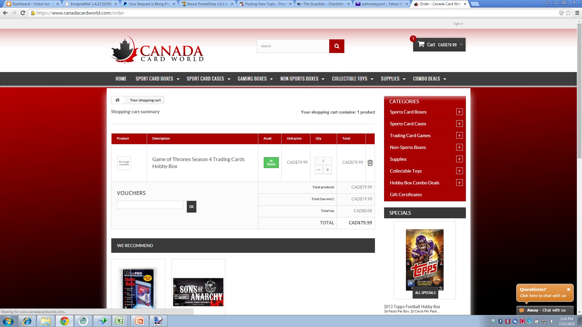

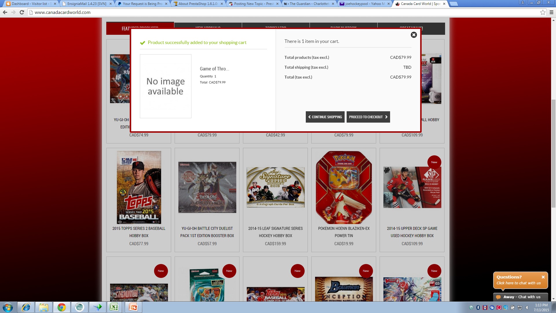

I also have the same problem, images do not show in the shopping cart after upgrading from 1.6.0.14 to 1.6.1. I use the default theme too. Like the others, I've also regenerated the images and this does not solve the issue. Even, when adding new products, the images are still missing from the shopping cart.

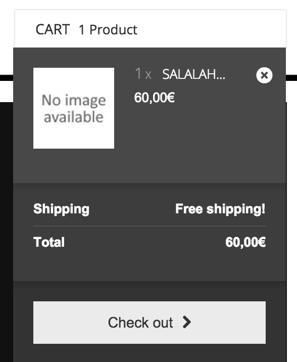

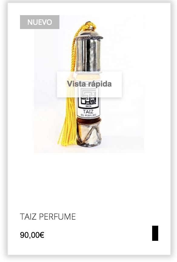

1. On the homepage, there should be a little icon cart on the bottom right  of each product. There is just a black rectangle? (see attached screenshot) and you can reference what it should look like with the url above of the original template.

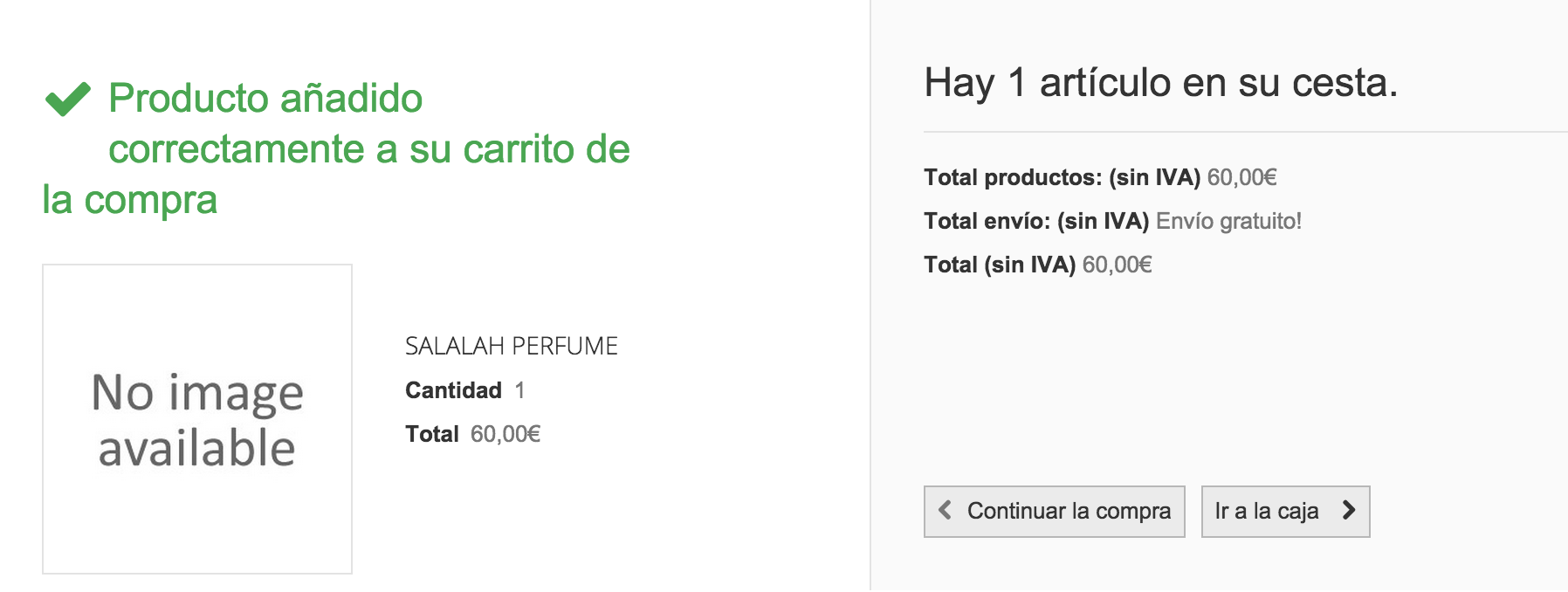

2. When I add a product to the cart and then proceed to the cart the thumbnail doesn't show. It also doesn't show in the final checkout process.

The featured products on the homepage are still missing the little shopping cart icon.
There is just a black triangle! Can you point me in the right direction to resolve this as it looks a bit...
