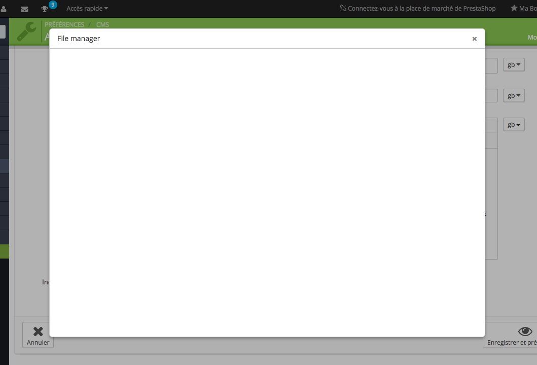

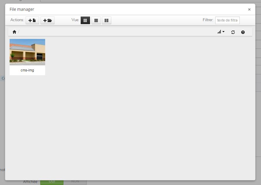

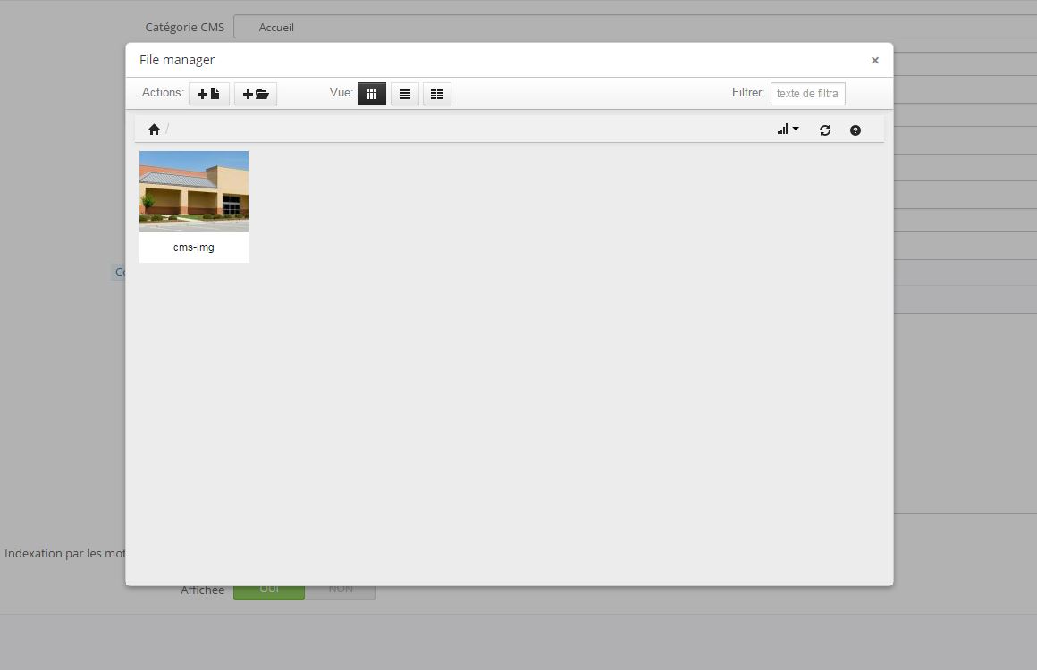

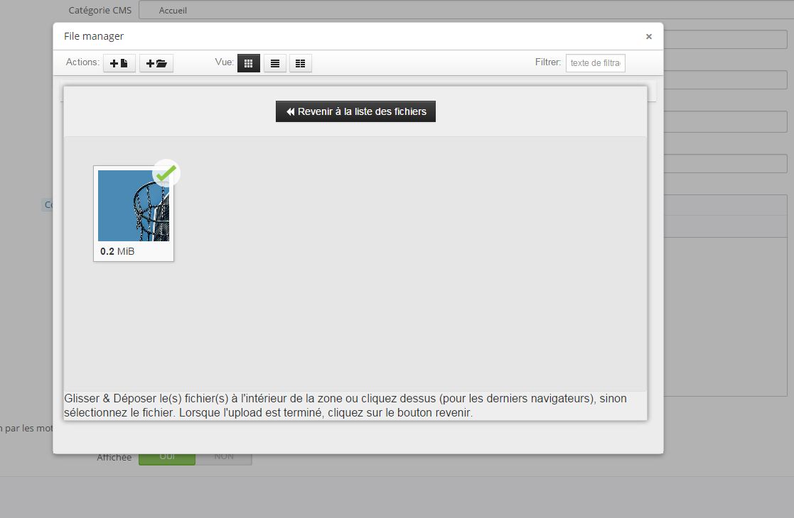

totaltolga Posted July 9, 2015 Share Posted July 9, 2015 (edited) Hi, I have an issue with the file manager : I open the file manager I upload a picture from my computer It uploads fine - I get a green tick I click "return to files" and my file is not there Please can anyone help? Edited July 9, 2015 by totaltolga (see edit history) Link to comment Share on other sites More sharing options...

ZikmaSolutions Posted July 9, 2015 Share Posted July 9, 2015 What version of PS you are using? Attach screenshot to know where are you uploading files. Link to comment Share on other sites More sharing options...
totaltolga Posted July 9, 2015 Author Share Posted July 9, 2015 I am using 1.6.0.11Screenshot is on my first post Link to comment Share on other sites More sharing options...

gonebdg - webindoshop.com Posted July 12, 2015 Share Posted July 12, 2015 hmmm really .. looking to your screenshot, the file manager seems has been opened from 3rd party module Try to upload an image file via FTP to ../img/cms/ this is the default destination directory of PS file manager and then open your PS file manager, the image file should be there. If it doesn't shown within your file manager: ensure the directory permission of ../img/cms/ is appropriated, chmod to 755 or 775 ensure you had ../img/tmp/cms/ directory and chmod to 755 or 775 check file manager config file ../YOUR_ADMIN_DIR/filemanager/config/config.php and make sure following variables are not changed/modified : $upload_dir = Context::getContext()->shop->physical_uri.'img/cms/'; // path from base_url to base of upload folder (with start and final /) $current_path = _PS_ROOT_DIR_.'/img/cms/'; // relative path from filemanager folder to upload folder (with final /) //thumbs folder can't put inside upload folder $thumbs_base_path = _PS_ROOT_DIR_.'/img/tmp/cms/'; // relative path from filemanager folder to thumbs folder (with final /) Link to comment Share on other sites More sharing options...
totaltolga Posted July 12, 2015 Author Share Posted July 12, 2015 (edited) I uploaded an image via FTP to img/cms and the image did show up when I opened the file manager to add some content via a Prestashop module, but when I opened a third party module to upload an image to it, it was not there.Also, I modified the config file as you have recommended on your post, and I couldn't even click to upload a picture or see files that have been uploaded already. See photo attached. So i restored the config file to what it was previously.And what how do I verify the "chmod" ? sorry but I have limited knowledge in this so I don't really know what this is.Thank you for your help Edited July 12, 2015 by totaltolga (see edit history) Link to comment Share on other sites More sharing options...

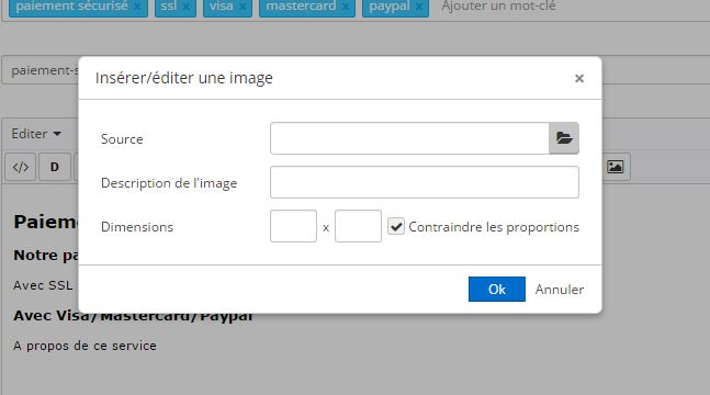

totaltolga Posted July 13, 2015 Author Share Posted July 13, 2015 Yes, I did restore it and nothing changed. I would love to give you more details about the error but I simply don't have any information regarding the error. No error message no nothing. Have a look at the screenshots I attach, each step. You will see that after step 3, when the image is uploaded correctly, I clcik on "return to files", I do so, and then the image is simply not there.The picture you see was already there by default with the theme I purchased. Link to comment Share on other sites More sharing options...

totaltolga Posted July 14, 2015 Author Share Posted July 14, 2015 (edited) Nothing related to filemanager in the log If this can help what I see in the Firebug window when I upload a picture is : POST admin7993/filemanager/upload.phpResponse : wrong pathOtherwhise shall I just reinstall the whole theme and start my site from the beginning ? Because I didn't have that problem in the beginning ... Edited July 14, 2015 by totaltolga (see edit history) Link to comment Share on other sites More sharing options...
gonebdg - webindoshop.com Posted July 14, 2015 Share Posted July 14, 2015 I see ... that's why you don't have any logs to have more info, please modify file : ../ADMIN/filemanager/upload.php Search for : $thumb_pos = strpos($_POST['path_thumb'], $thumbs_base_path); and paste following code underneath : PrestaShopLogger::addLog('FILE MANAGER [1][wrong path] > '.Tools::jsonEncode(array( 'path_pos' => $path_pos, 'thumb_pos' => $thumb_pos, '$_POST[\'path_thumb\']' => $_POST['path_thumb'], '$_POST[\'path\']' => $_POST['path'], ))); Try to upload image again with your file manager. Now, you should have FILE MANAGER log, copy-paste here What is your php version ?Back Office > Advanced Paramateres > Configuration informationsCopy-paste block "Server information" in here Link to comment Share on other sites More sharing options...
totaltolga Posted July 14, 2015 Author Share Posted July 14, 2015 Ok!! I feel already happy to at least get an error message. Log : FILE MANAGER [1][wrong path] > {\"path_pos\":0,\"thumb_pos\":0,\"$_POST[\'path_thumb\']\":\"\\/home\\/sportletam\\/www.\\/img\\/tmp\\/cms\\/\",\"$_POST[\'path\']\":\"\\/home\\/sportletam\\/www.\\/img\\/cms\\/\"}Server information : Linux #1 SMP Thu Apr 16 08:53:31 UTC 2015 x86_64 Apache Version de PHP 5.4.38 Memory 512M (max_execution_time) 300 Link to comment Share on other sites More sharing options...

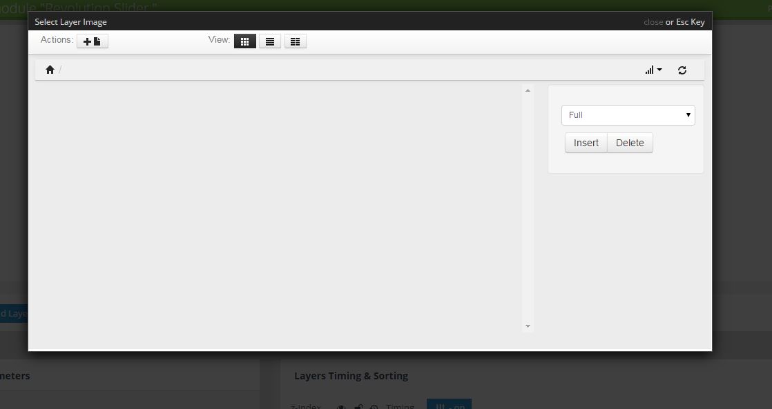

suziechs Posted August 15, 2016 Share Posted August 15, 2016 I have this issue with revolution Slider also. Uploaded the module and installed, when adding images with the module I can sometimes get an image to upload and sometimes not.I can add images in prestashop with add product with no problems.I tried re installing the module rev slider and still no luck.I run Prestashop 1.6.1.0 and Revolution Slider. v5.1.6 Extremely frustrated Link to comment Share on other sites More sharing options...
vekia Posted August 15, 2016 Share Posted August 15, 2016 if problem occurs only sometimes this usually means that it is a host problems, not the prestashop / module you use. Link to comment Share on other sites More sharing options...
