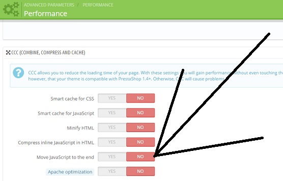

musicmaster Posted June 24, 2015 Share Posted June 24, 2015 Eickhardt, I don't know about PS 1.6.0.5. However, in PS 1.6.0.11 I have it under Advanced Parameters -> Performance. See also the attached image. Link to comment Share on other sites More sharing options...
