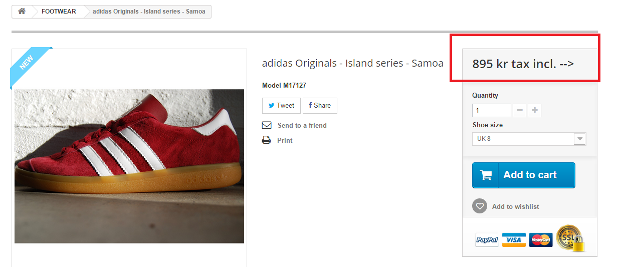

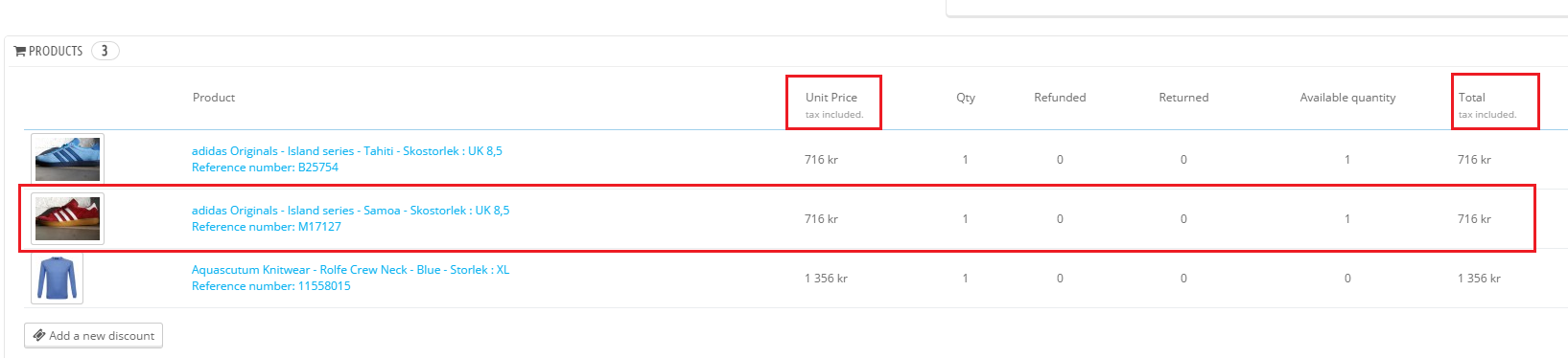

Ako Posted June 17, 2015 Share Posted June 17, 2015 Hi, I've been trying to wrap my head around this but I can't find the setting for international buyers. I run a Swedish clothing store www.borstahusenclothing.se but I have quite many international buyers. The problem is that, for some unknown reason, isn't tax paid when someone buys from e.g. NL or NO. For instance (screens attached) a pair of Adidas shoes cost 895 SEK tax inc and 716 SEK tax ex. Swedish visitors pay 895 SEK but international buyers only pay 716 SEK. In attached screens it's stated that tax inc and ex are the same. Any thoughts? I'm in desperate help here since the big sale is coming. Thanks in advance. Link to comment Share on other sites More sharing options...

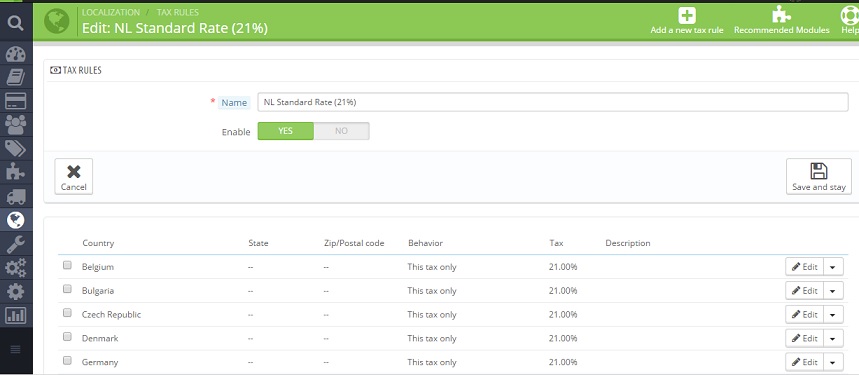

musicmaster Posted June 19, 2015 Share Posted June 19, 2015 You should not be under taxes. You should be under tax rules. When you edit a tax rule you see something like the attached picture and you can different rates for different countries. Link to comment Share on other sites More sharing options...
