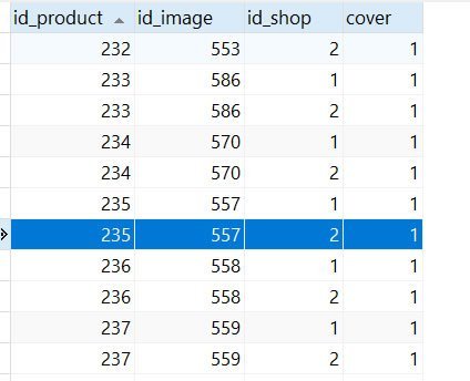

ecentury Posted September 24, 2024 Share Posted September 24, 2024 For me, the solution to the "an error occurred while creating an additional image" was that there was no entry for this image in this table: ps_image_shop There was an entry for one of the multi shops, but not the other one. So added row as can be seen in the image This also shows that maybe your database needs a bit of maintenance and clearing out to improve performance hope that helps someone Link to comment Share on other sites More sharing options...
