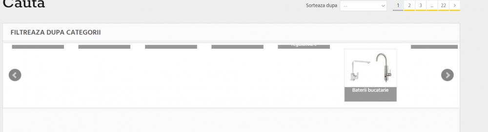

ru5hm3 Posted April 29, 2021 Share Posted April 29, 2021 (edited) if i delete this file /cache/class_index.php, will afect with something my store? or this file is rebuilding? atm my page is returning like this the results i want to use the code from cyberespia, now i must enter and add img in subcategory details for each subcategory and i want the img to be added randomly Thnx in advance for answer! Edited April 29, 2021 by ru5hm3 explain my error (see edit history) Link to comment Share on other sites More sharing options...
