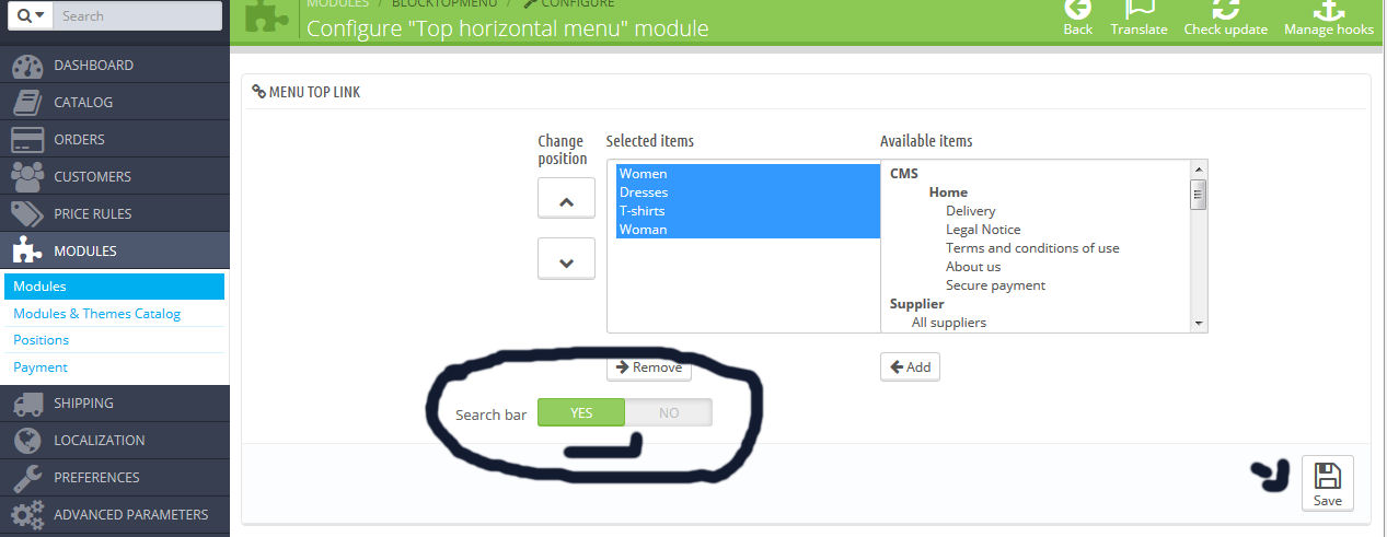

selectshop.at Posted June 3, 2015 Share Posted June 3, 2015 (edited) You should do it by the way I told you on topic#2 Go on your back-office on TAB modules -> modules -> search for blocktopmenu -> edit -> Check the search box (s. screen) -> save . Disable than after the "quicksearchblock" module to don't show it twice. Clear than after cache of your browser and smarty cache (Tab "advanced parameters -> performance -> on top button "clear cache"). For to clear your borwser cache: Key F5 on your keyboard. Edited June 3, 2015 by selectshop.at (see edit history) Link to comment Share on other sites More sharing options...
