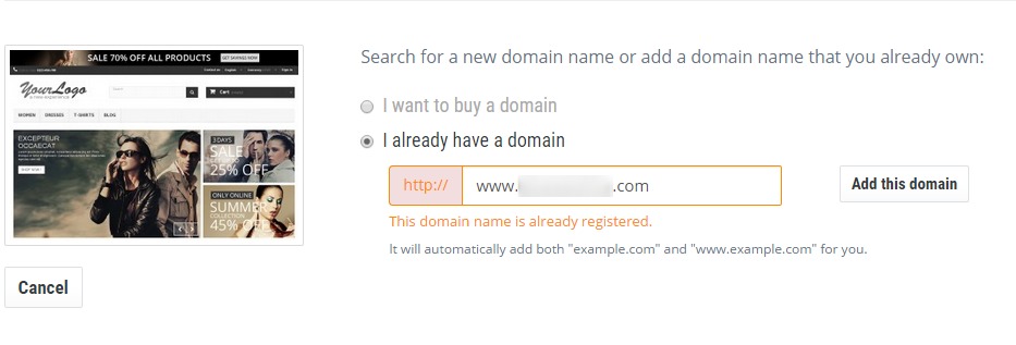

Hi Everybody,
I read at the documentation that if I need my store to be available both through its raw domain name and it's www-prefixed version (for example, my-store.co.uk and www.my-store.co.uk), I have to add the domain name with the www. in the "Store details" page of my store..
But I tried many times, and the page always shows: This domain name is already registered. Which is not real... I only succesfull added my domain name WITHOUT www. prefix.

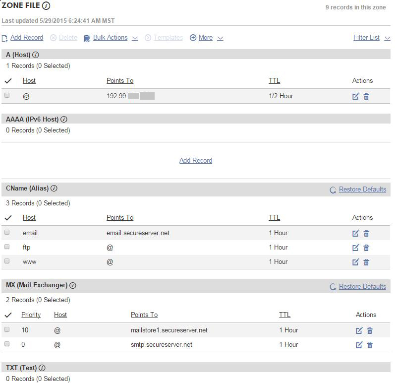

In that case, I have to check the DNS setting with my Domain admin (Godaddy) and then try to add my domain including the www. prefix, right? I'm attaching my DNS settings, can you please check where can be the problem?

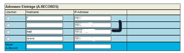

A-Records are not configured correctly
DNS should be like this:
Second line on my DNS panel is for WITHOUT WWW. Perhaps you've/your DNS admin added some other rewrite on his DNS-Server for to work ? But it is not correct.
Line www is for with www, line blank hostname is for without www. * is for general purposes (equivalent to your @ entry), and mail is for mail.

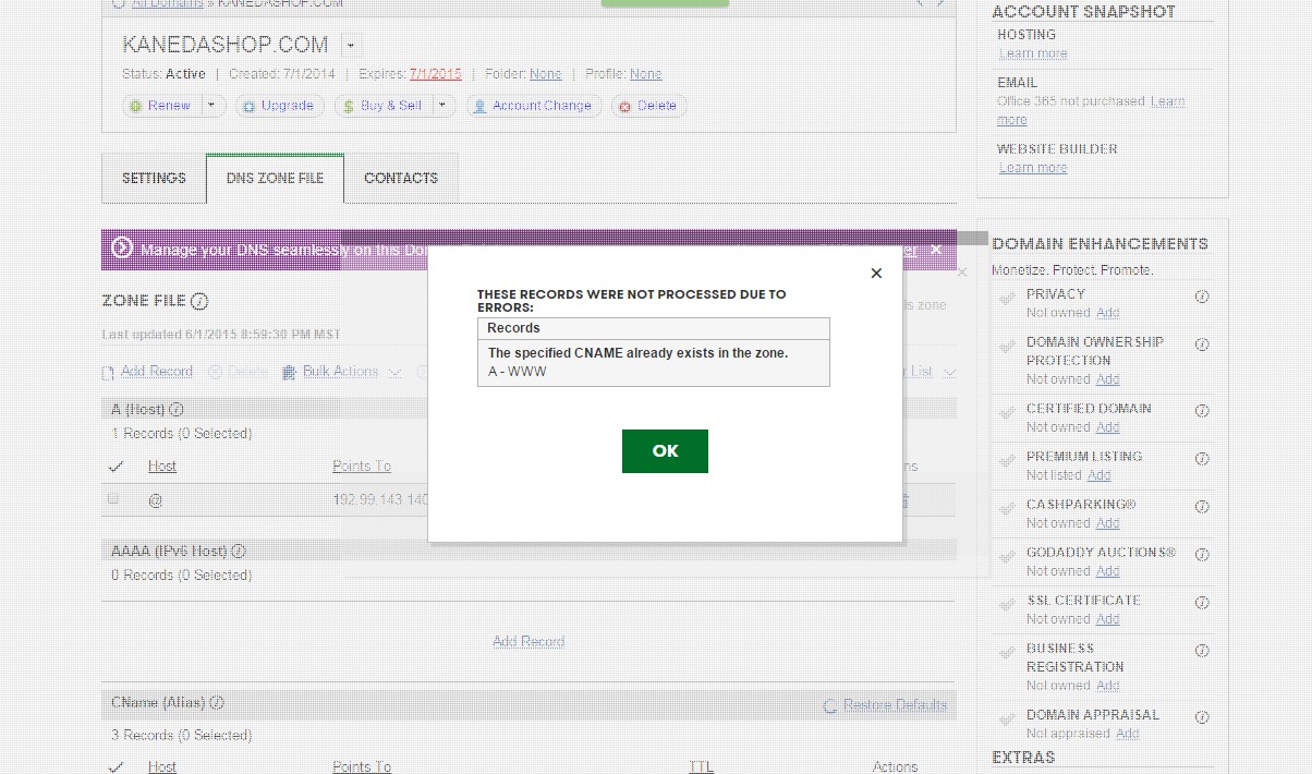

I tried to add the www. A-Record (A-Host at Godaddy), but the system goes error message:
"the specified CNAME already exists in the zone. A-WWW" (please view attached image 1)

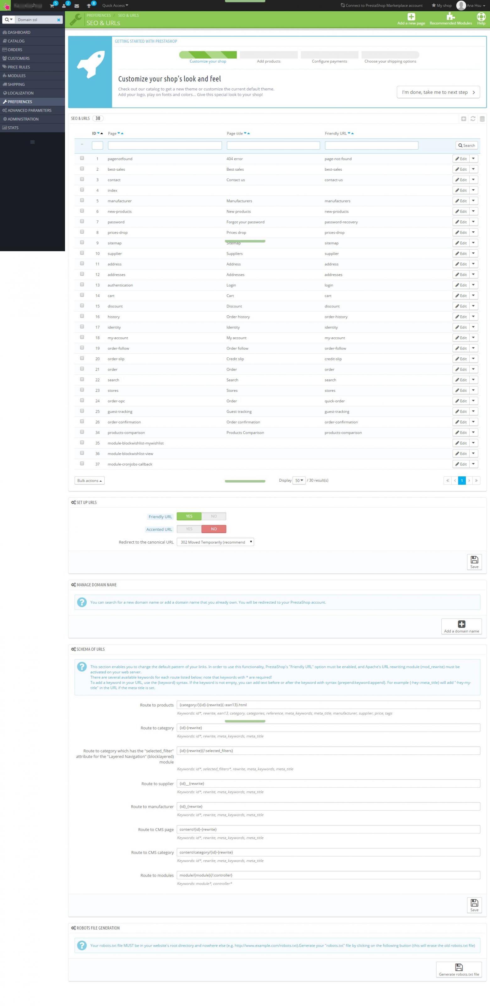

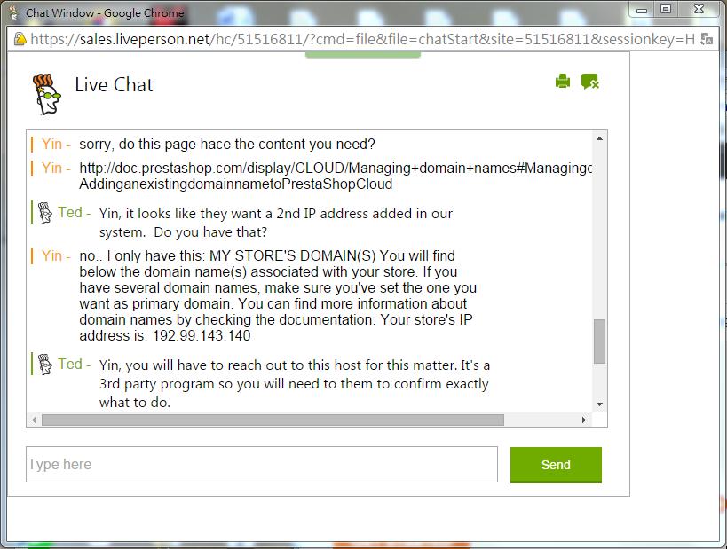

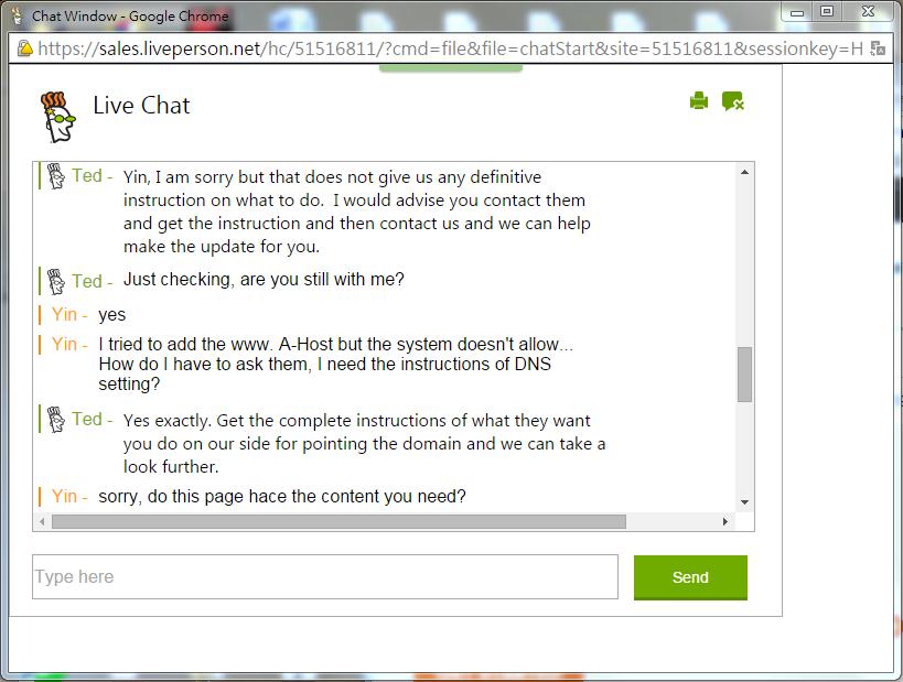

So I pasted this topic to Godaddy support, and they say that they need the instructions of DNS settings for proceed.
Even when I give them the documentation page, they doesn't understand exactly what should do.....
(Conversation attached@ image 2 & 3)

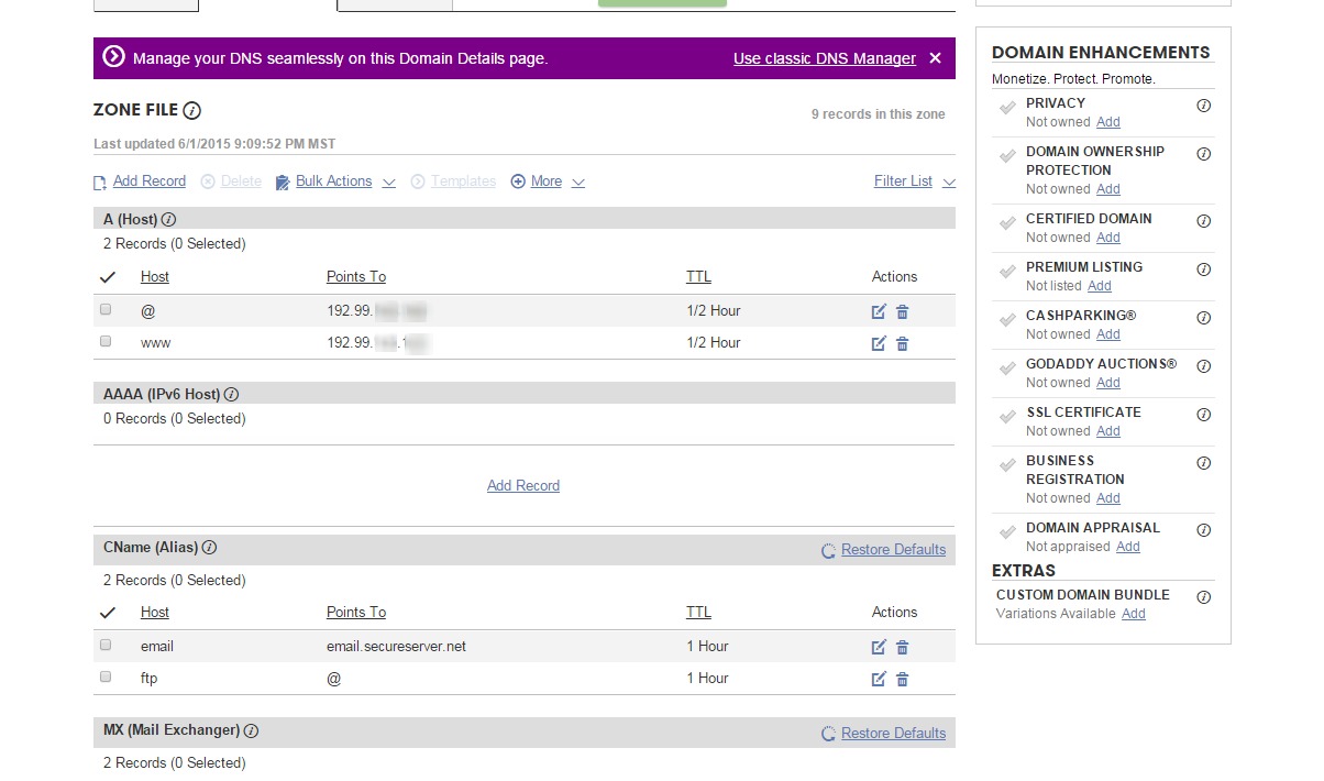

I tried by my self, deleting the CNAME and including the WWW A-Host like your DNS setting, and system shows will update in one hour, but it passed half day and it's not working until now..... (please see image 4)
