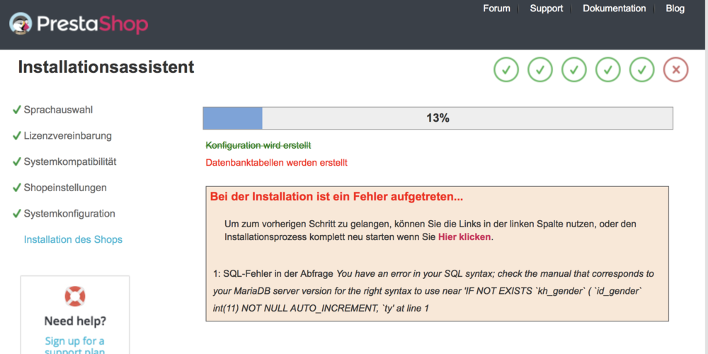

Tschüssy Klamotten Posted November 3, 2017 Share Posted November 3, 2017 Hello everyone, same problem here with installing PrestaShop 1.7.2.4, stopping at 13% of the installation process. Does anyone know what to do with the error description attached? Thankful for answers after having an endless list of PrestaShop installation problems that I already fixed myself. Cannot understand why there are always problems with PrestaShop. Best Victoria Bei der Installation ist ein Fehler aufgetreten... 1: SQL-Fehler in der Abfrage You have an error in your SQL syntax; check the manual that corresponds to your MariaDB server version for the right syntax to use near 'IF NOT EXISTS `kh_gender` ( `id_gender` int(11) NOT NULL AUTO_INCREMENT, `ty' at line 1 Link to comment Share on other sites More sharing options...
bellini13 Posted November 3, 2017 Share Posted November 3, 2017 what is the version of MariaDB being used? It may be too new for Prestashop. Link to comment Share on other sites More sharing options...
Tschüssy Klamotten Posted November 3, 2017 Share Posted November 3, 2017 Dear bellini13, thank you for your super fast reply. phpMyAdmin version: 4.7.2 MariaDB version: 10.0.33 Link to comment Share on other sites More sharing options...
bellini13 Posted November 4, 2017 Share Posted November 4, 2017 First thing you should do using phpmyadmin is to see if the table named kh_gender exists in your prestashop database. Based on the error you received, it should not exist since the install failed at this point. Assuming it does not exist, then take the following statement, and again using phpmyadmin execute this statement to create the table. CREATE TABLE IF NOT EXISTS `kh_gender` ( `id_gender` int(11) NOT NULL AUTO_INCREMENT, `type` tinyint(1) NOT NULL, PRIMARY KEY (`id_gender`) ) DEFAULT CHARSET=utf8 COLLATION; If the issue is with your database server, then it should fail again. If it does not fail, then the issue is somewhere else and that will be rather difficult to troubleshoot on the forum. If that table already exists, then you'll need to think about why it would exist if creating the table during the upgrade failed. Perhaps you have attempted to install PS more than once, and it failed previously? If that is the case, you should really delete these tables first, and then re-try the install. I'd also be curious to which version of PHP is being used Link to comment Share on other sites More sharing options...
