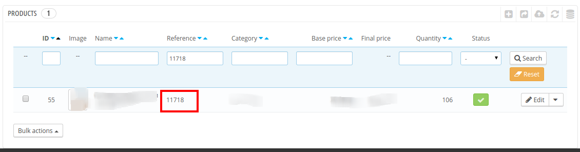

How can i add only that product?

No error, indexing was fine but no effect on result.
