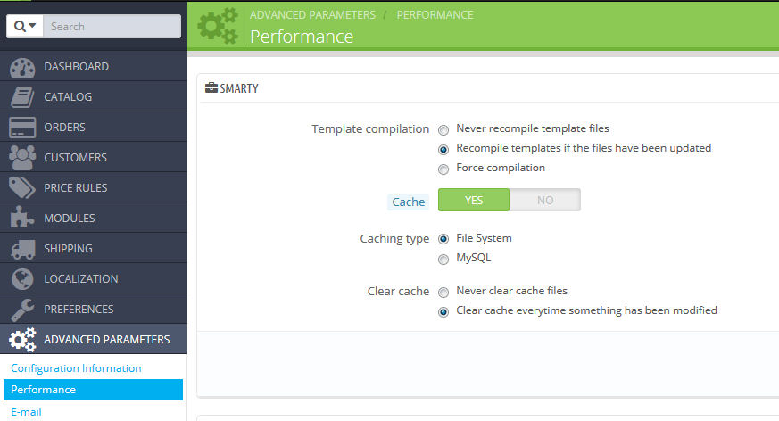

selectshop.at Posted May 2, 2015 Share Posted May 2, 2015 (edited) The error line is: return Smarty_Internal_Utility::clearCompiledTemplate($resource_name, $compile_id, $exp_time, $this); Seems that you installed a second template which is not compatible ? If yes, please uninstal the template. If not, you should revise the settings of cache and smarty on your server. Please see attached screen for native settings, you should not change. Edited May 2, 2015 by selectshop.at (see edit history) Link to comment Share on other sites More sharing options...

steffenborg Posted May 2, 2015 Author Share Posted May 2, 2015 The error line is: return Smarty_Internal_Utility::clearCompiledTemplate($resource_name, $compile_id, $exp_time, $this); Seems that you installed a second template which is not compatible ? If yes, please uninstal the template. If not, you should revise the settings of cache and smarty on your server. Please see attached screen for native settings, you should not change. I have my installation set to these settings, and I do not have any other templates installed. It is very strange, another installation I have created at almost same time makes no errors. Link to comment Share on other sites More sharing options...
selectshop.at Posted May 2, 2015 Share Posted May 2, 2015 The other installation is on same server ? Same Prestashop version ? Same settings ? Which settings are you using for CCC (same tab, one block under smarty) Link to comment Share on other sites More sharing options...

selectshop.at Posted May 2, 2015 Share Posted May 2, 2015 Brug Cache = NO. Activate Brug Cache only if you have installed APC, memcache or xCache. Filesystem is not a good caching system, besides make some troubles. In this case it is better to don't activate. Please ask your provider, if APC, memcache or XCache is installed on your server. If yes you can the one which is installed. CCC you should ask your provider if your server supports combine, compress and compile. But you can simply activate all options there and test by yourself. If the server supports them, than speed of your site will increase. Better performance you will notice merely only on pages with 2.000 products upwards. Link to comment Share on other sites More sharing options...
steffenborg Posted May 2, 2015 Author Share Posted May 2, 2015 Brug Cache = NO. Activate Brug Cache only if you have installed APC, memcache or xCache. Filesystem is not a good caching system, besides make some troubles. In this case it is better to don't activate. Please ask your provider, if APC, memcache or XCache is installed on your server. If yes you can the one which is installed. CCC you should ask your provider if your server supports combine, compress and compile. But you can simply activate all options there and test by yourself. If the server supports them, than speed of your site will increase. Better performance you will notice merely only on pages with 2.000 products upwards. Thanks for your comments, but do you have any idea what is causing the problem? :-) Link to comment Share on other sites More sharing options...
