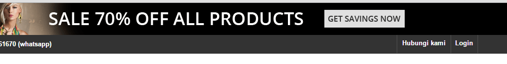

rafazka Posted April 28, 2015 Share Posted April 28, 2015 Bagaimana cara menambahkan menu dan link di bagian atas dibawah banner (di samping kiri "Hubungi Kami"). ------- Maaf pertanyaanya dasar banget. Sudah saya cari tapi tidek diketemukan. Terimaaksih Link to comment Share on other sites More sharing options...
duredo Posted April 29, 2015 Share Posted April 29, 2015 edit file ini /themes/default-bootstrap/modules/blockuserinfo/nav.tpl lalu tambahkan, contoh: <div class="header_user_info"> <a href="http://www.domainanda.com/" title="Nama Menu Anda">NamaMenu</a> </div> Link to comment Share on other sites More sharing options...
