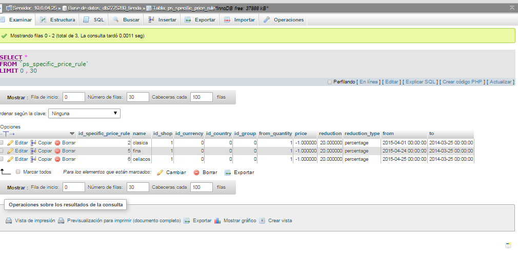

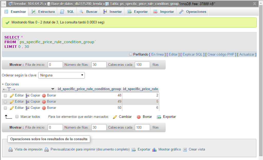

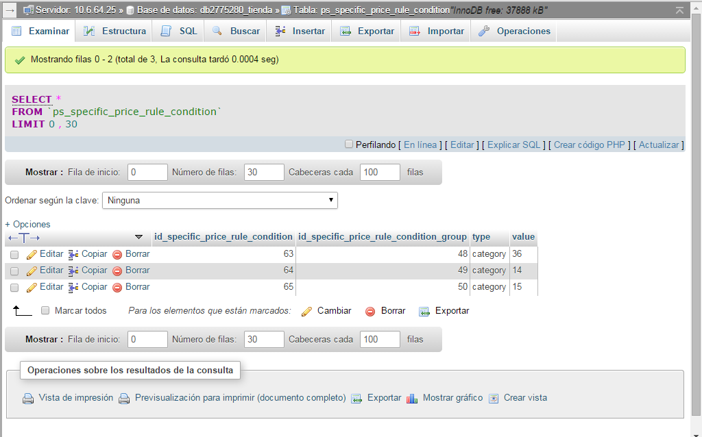

erty2288 Posted April 26, 2015 Author Share Posted April 26, 2015 Hola apositivo. Gracias por tu mensaje pero no he acabado de entender el procedimiento, bueno mas bien como llevarlo a cabo. Lo que tengo son 3 reglas para tres grupos distintos de productos aunque el descuento seria igual para las tres y ademas a las mismas horas. Adjunto subo fotos de las tres tablas tal y como me has comentado a ver si me puedes ir guiando en el proceso... Muchas gracias. Link to comment Share on other sites More sharing options...
apositivo Posted April 27, 2015 Share Posted April 27, 2015 hola, erty2288, saludos. script 1 a ejecutar < DESABILITAR todas las reglas > $hostname=""; $username=""; $password=""; $dbname=""; $connection = mysql_connect($hostname, $username, $password) or die(mysql_error()); mysql_select_db($dbname, $connection)or die(mysql_error()) ; $query = "SELECT id_specific_price_rule FROM ps_specific_price_rule"; $result = mysql_query($query); while($row=mysql_fetch_array($result)) { $query2 = "DELETE ps_specific_price_rule_condition , ps_specific_price_rule_condition_group FROM ps_specific_price_rule_condition INNER JOIN ps_specific_price_rule_condition_group WHERE ps_specific_price_rule_condition.id_specific_price_rule_condition_group = ps_specific_price_rule_condition_group.id_specific_price_rule_condition_group AND ps_specific_price_rule_condition_group.id_specific_price_rule = ".$row['id_specific_price_rule'].""; mysql_query($query2); $query3 = "DELETE FROM ps_specific_price_rule WHERE id_specific_price_rule = ".$row['id_specific_price_rule'].""; mysql_query($query3); } $array = array("ps_specific_price_rule","ps_specific_price_rule_condition", "ps_specific_price_rule_condition_group"); foreach($array as $name) { $query4 = "ALTER TABLE ".$name." AUTO_INCREMENT = 1"; mysql_query($query4) or die ("Couldn't change table".mysql_error()); } script 2 a ejecutar <HABILITA TODAS LAS REGLAS> $hostname=""; $username=""; $password=""; $dbname=""; $connection = mysql_connect($hostname, $username, $password) or die(mysql_error()); mysql_select_db($dbname, $connection)or die(mysql_error()) ; $arrayreglas = array ( array("clasica",1,0,0,0,1,-1,20,"percentage","2015-04-01 00:00:00","2014-03-25 00:00:00"), array("fina",1,0,0,0,1,-1,20,"percentage","2015-04-24 00:00:00","2014-03-25 00:00:00"), array("celiacos",1,0,0,0,1,-1,20,"percentage","2015-04-25 00:00:00","2014-03-25 00:00:00") ); $arrayConditionGroup = array(36,14,15); foreach($arrayreglas as $reglas) { $values = ""; foreach($reglas as $elemento) { $values.= "'$elemento',"; } $values = trim($values, ','); $query1 ="INSERT INTO ps_specific_price_rule (`name`,`id_shop`,`id_currency`,`id_country`,`id_group`,`from_quantity`,`price`,`reduction`,`reduction_type`,`from`,`to`) VALUES ($values)"; mysql_query($query1) or mysql_error(); $id_specific_price_rule = mysql_insert_id(); $query2 ="INSERT INTO ps_specific_price_rule_condition_group (`id_specific_price_rule`) VALUES ($id_specific_price_rule)"; mysql_query($query2) or mysql_error(); $id_specific_price_rule_condition_group = mysql_insert_id(); $query3 ="INSERT INTO ps_specific_price_rule_condition (`id_specific_price_rule_condition_group`,`type`, `value`) VALUES ($id_specific_price_rule_condition_group, 'category',".$arrayConditionGroup[$id_specific_price_rule-1].")"; mysql_query($query3) or mysql_error(); } saludos ! espero haberte ayudado. . . cualquier cosa estoy a la orden por whatsapp o skype ! Link to comment Share on other sites More sharing options...

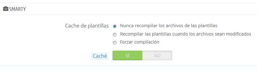

apositivo Posted April 28, 2015 Share Posted April 28, 2015 wow fenomenos paranormales en prestahop ! jejejeje que version de PS usas ? no tienes activada alguna regla de compra, de catalogo o algun modulo de descuentos ? Link to comment Share on other sites More sharing options...
erty2288 Posted April 29, 2015 Author Share Posted April 29, 2015 (edited) Hola apositivo. Pues la verdad es que otra explicacion no encuentro... Modulos de descuentos no tengo ninguno instalado y reglas de compra y de catalogo, tengo las que estamos intentando configurar de esta manera. Lo que si que me he dado cuenta es de que debe de existir alguna otra tabla en la B.D. en donde se queden registrados datos al respecto de las reglas de descuento que se van creando, porque por ejemplo hemos creado un total de 10 reglas de descuento desde que instalamos prestashop, y las borramos las 10, en las tablas y en back office no hay nada al respecto pues las hemos borrado. Pues si creamos una nueva, automaticamente se le asigna el numero 11 a esa nueva regla de descuento, es decir, de algun sitio prestashop tiene que sacar la informacion de que ha habido un total de 10 reglas antes, y que la siguiente tiene que ser la 11. Es por eso por lo que creo que si se crean o se borran reglas directamente desde las tablas de la B.D. no surten efecto en la tienda aunque en el back office aparezca la modificacion, porque sigue encontrando informacion antigua en ese sitio. Voy a seguir investigando, sino tendre que amoldarme creando vales de descuento que esos si que se pueden activar y desactivar directamente desde la B.D. con un script y surten efecto al instante en la tienda. Un saludo y muchas gracias por tu tiempo. Se me olvido comentar que mi version es la 1.6.0.9 Edited April 29, 2015 by erty2288 (see edit history) Link to comment Share on other sites More sharing options...
apositivo Posted April 30, 2015 Share Posted April 30, 2015 hemos creado un total de 10 reglas de descuento desde que instalamos prestashop, y las borramos las 10, en las tablas y en back office no hay nada al respecto pues las hemos borrado. Pues si creamos una nueva, automaticamente se le asigna el numero 11 a esa nueva regla de descuento, es decir, de algun sitio prestashop tiene que sacar la informacion de que ha habido un total de 10 reglas antes, y que la siguiente tiene que ser la 11. eso ocurre por que en la definicion de ese campo en la BD es AUTOINCREMENT , el siguiente que se inserta es uno mas con respecto a la ultima inserccion , asi borres todos los registros. para reiniciar este valor en 1 lo puedes hacer con la senetencia alter tablet o con truncate Link to comment Share on other sites More sharing options...
