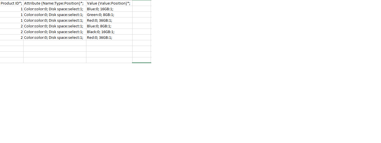

I'm using CSV to import one combination set for multiple products. As a start, I did it for wo products as test. After import, it pops out "Your .CSV file has been successfully imported into your shop.". However, when I check the results either on back or front office, only one value of the combination was imported. Did anyone know hot to figure it out?

I used default ',' as Multiple Value Separator and ';' as Field Separator. After the csv file imported, everything seems OK and it looks like this: https://www.dropbox.com/s/wz9pkuz62mb7wd2/After%20import.png?dl=0
But it turns out only the last value of each product was successfully imported.
If you have time, you may check my original csv file here and see if there is any problem with the file itself.

Field separator -> ,
Multiple Value Separator -> ;
And try to separate each field in separate column in csv file.
Dont forget to save as CSV file.
