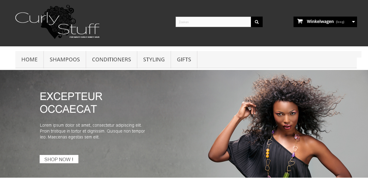

steviger Posted April 7, 2015 Share Posted April 7, 2015 (edited) Hi guys, I would like to move the horizontal top menu just below the slider like the design in the attached image. Apparently it can't be transplanted to the hook displayTopColumn.I found this post but there's no reaction (yet).The Vekia solution is for transplanting the module to displayHeader section. Anyone?Thanks in advance!Cheers,Steven Edited April 8, 2015 by steviger (see edit history) Link to comment Share on other sites More sharing options...
