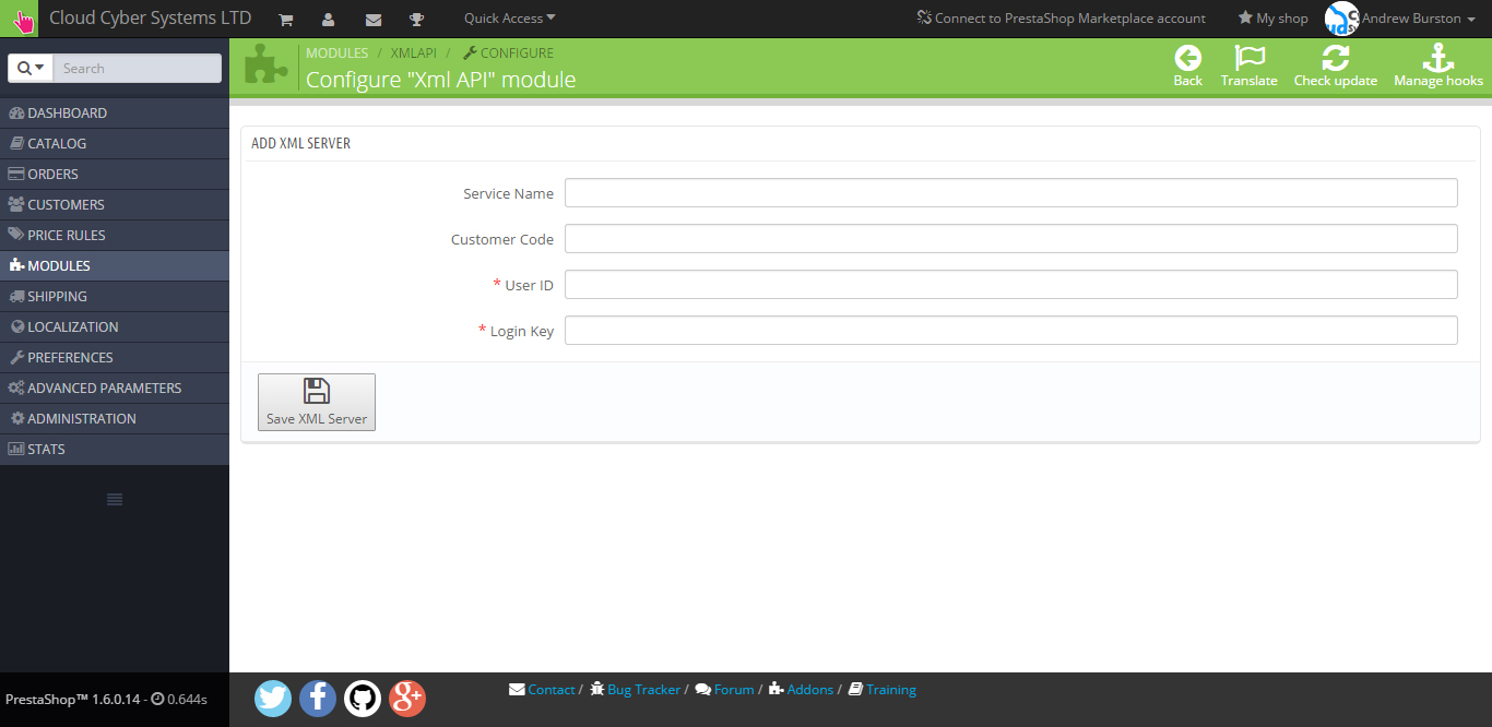

Thanks for the help rytiz2873, I have modified the code as follows;
  protected function renderForm()
		$default_lang = (int)Configuration::get('PS_LANG_DEFAULT');
		$fields_form = array(
			'tinymce' => true,
			'legend' => array(
				'title' => $this->l('Add XML Service'),
			'input' => array(
				'xml_service_id' => array(
					'type' => 'hidden',
					'name' => 'xml_service_id'
				'content' => array(
					'type' => 'text',
					'label' => $this->l('Service Name'),
					'lang' => true,
					'name' => 'xml_service_name',
					'size' => '15',
					'class' => 'rte',
                'required' => true
				'content' => array(
					'type' => 'text',
					'label' => $this->l('Customer Code'),
					'lang' => true,
					'name' => 'xml_service_customer_code',
					'size' => '15',
					'class' => 'rte',
                'required' => true
			'submit' => array(
				'title' => $this->l('Add Service'),
			'buttons' => array(
				array(
					'href' => AdminController::$currentIndex.'&configure='.$this->name.'&token='.Tools::getAdminTokenLite('AdminModules'),
					'title' => $this->l('Back to list'),
					'icon' => 'process-icon-back'
		if (Shop::isFeatureActive() && Tools::getValue('xml_service_id') && Tools::getValue('xml_service_name') == false)
			$fields_form['input'][] = array(
				'type' => 'shop',
				'label' => $this->l('Shop association'),
				'name' => 'checkBoxShopAsso_theme'
		$helper = new HelperForm();
		$helper->module = $this;
		$helper->name_controller = $this->name;
		$helper->identifier = $this->identifier;
		$helper->token = Tools::getAdminTokenLite('AdminModules');
		foreach (Language::getLanguages(false) as $lang)
			$helper->languages[] = array(
				'id_lang' => $lang['id_lang'],
				'iso_code' => $lang['iso_code'],
				'name' => $lang['name'],
				'is_default' => ($default_lang == $lang['id_lang'] ? 1 : 0)
		$helper->currentIndex = AdminController::$currentIndex.'&configure='.$this->name;
		$helper->default_form_language = $default_lang;
		$helper->allow_employee_form_lang = $default_lang;
		$helper->toolbar_scroll = true;
		$helper->title = $this->displayName;
		$helper->submit_action = 'submit'.$this->name;
		$helper->fields_value = $this->getFormValues();
		return $helper->generateForm(array(array('form' => $fields_form)));
public function getFormValues()
		$fields_value = array();
		$xml_service_id = (int)Tools::getValue('xml_service_id');
			if ($xml_service_id)
				$info = new InfoBlock((int)$xml_service_id);
				$fields_value['text'][(int)$lang['id_lang']] = $info->text[(int)$lang['id_lang']];
			else
				$fields_value['text'][(int)$lang['id_lang']] = Tools::getValue('text_'.(int)$lang['id_lang'], '');
		$fields_value['xml_service_id'] = $xml_service_id;
		return $fields_value;
But the form is only showing the "Customer Code" text area... not Service Name & Customer Code
Edited by CloudCyberSystems (see edit history)
this is sample how to add hidden field (in your case is "xml_api", if this is your id) and how to load fields values
The hidden field has been added :)
what i mean is there should be to visible fields now
'input' => array(
					'type' => 'hidden',
				'content' => array(
					'type' => 'text',
					'lang' => true,
					'size' => '15',
					'class' => 'rte',
                'required' => true
				'content' => array(
					'type' => 'text',
					'lang' => true,
					'size' => '15',
					'class' => 'rte',
                'required' => true
Service Name
Customer Code
you used two times "content", use same values as field name
Great! all fields are showing now.
but when i fill out the form and press save I get
Invalid Configuration value
