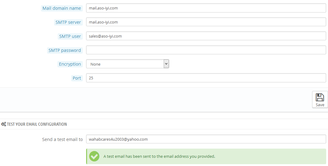

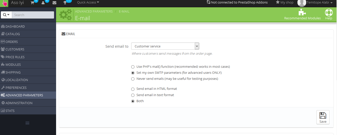

temmyazeezcouture Posted November 29, 2015 Share Posted November 29, 2015 Really need help regarding my Prestashop SMTP. It keep bouncing back my messages. I have setup my mail server on Microsoft outlook ,it work fine but when i set it up through SMTP server on prestashop, it shows successful registered. But anytime it suppose to send mail to my customers. The message bounce back to my customer care email. Below are the pictures will explained better Link to comment Share on other sites More sharing options...
