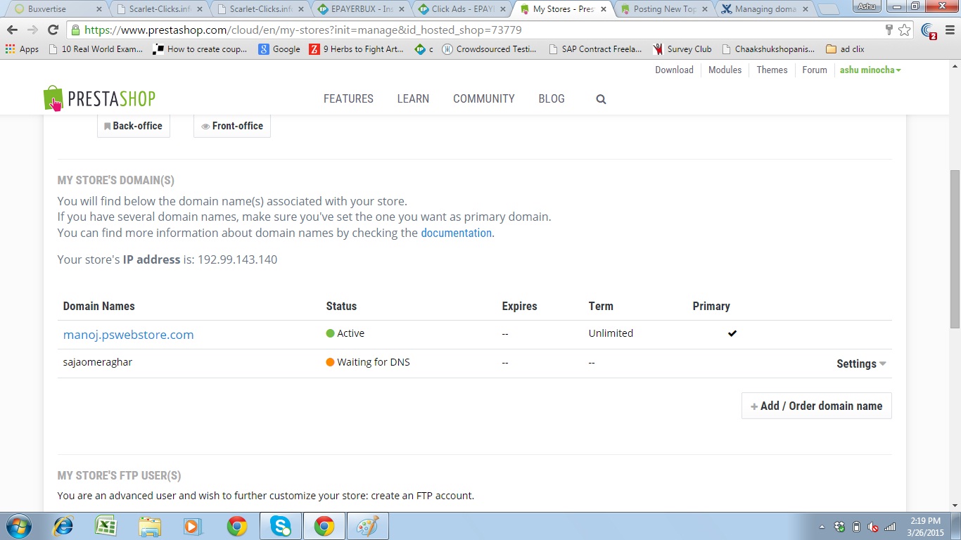

ashu13 Posted March 26, 2015 Share Posted March 26, 2015 Hi, I have created my store on prestashop cloud. Everything is fine. The only problem i am facing is with domain linking. Althoough i have followed the same instruction as mentioned in http://doc.prestashop.com/display/CLOUD/Managing+domain+names#Managingdomainnames-AddinganexistingdomainnametoPrestaShopCloud Now, when trying to access my store url www.sajaomeraghar.com, it is redirecting me to https://www.prestashop.com/forums/app=core§ion=login&referer=https%3A%2F%2Fwww.prestashop.com%2Fcloud%2Fen%2F%3Furl%3Dwww.sajaomeraghar.com%252F And when looking into the manage store section, it is showing me status as "Waiting for DNS". Please help me at your earliest as i have already make the site live. Thanks in Advance !! Suggestion and help are appreciated !! Thanks, Ashu Link to comment Share on other sites More sharing options...

Question
ashu13
Hi,
Thanks,
Ashu
