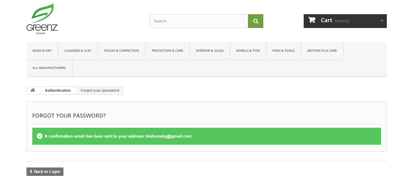

kishoreunni Posted April 13, 2015 Author Share Posted April 13, 2015 (edited) All works fine but when i do the following things i do not get the exact thing. 1] i have already registered as a customer in the fo with an email account. 2] but when i click on forgot password it shows a message saying this 3] when i open my email account it does not have any confirmation message. ie: it doesnot send any message to my mail. please help me Thanks in advance Edited April 13, 2015 by kishoreunni (see edit history) Link to comment Share on other sites More sharing options...

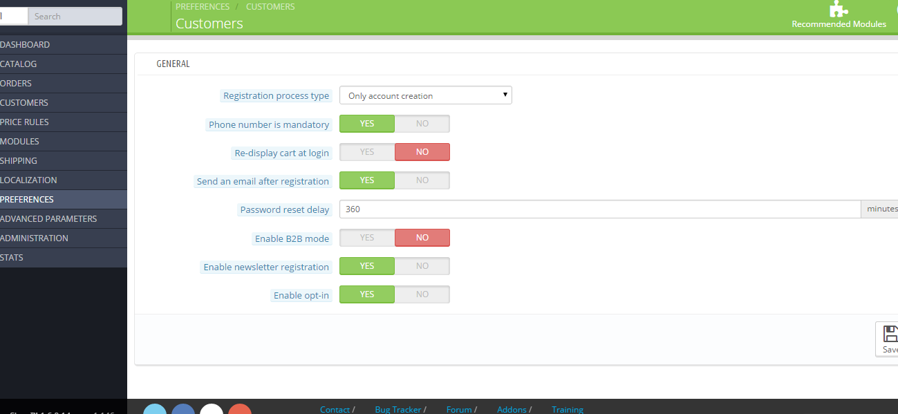

selectshop.at Posted April 14, 2015 Share Posted April 14, 2015 All works fine but when i do the following things i do not get the exact thing. 1] i have already registered as a customer in the fo with an email account. 2] but when i click on forgot password it shows a message saying this asd.png 3] when i open my email account it does not have any confirmation message. ie: it doesnot send any message to my mail. please help me Thanks in advance You activated the mails ? Tab customers -> customers -> Send an email after registration = YES. Link to comment Share on other sites More sharing options...
kishoreunni Posted April 15, 2015 Author Share Posted April 15, 2015 You activated the mails ? Tab customers -> customers -> Send an email after registration = YES. there is no such option in Tab customers -> customers -> Send an email after registration whether it is this iam not having such an option thanks please help me Link to comment Share on other sites More sharing options...
selectshop.at Posted April 16, 2015 Share Posted April 16, 2015 Sorry, I wrote wrong direction: Tab "preferences -> customers" Link to comment Share on other sites More sharing options...
kishoreunni Posted April 16, 2015 Author Share Posted April 16, 2015 Sorry, I wrote wrong direction: Tab "preferences -> customers" I have done that but no confirmation message is shown in the mail. Link to comment Share on other sites More sharing options...

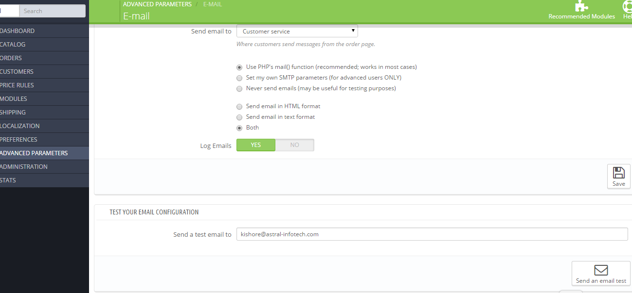

selectshop.at Posted April 16, 2015 Share Posted April 16, 2015 Your are receiving test mail ? You tried to change the function to php-mail instead SMTP. You are receiving than test mail ? If yes, so something wrong with the configuration of your SMTP or mail server. Link to comment Share on other sites More sharing options...

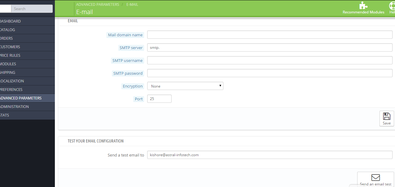

kishoreunni Posted April 17, 2015 Author Share Posted April 17, 2015 (edited) Your are receiving test mail ? You tried to change the function to php-mail instead SMTP. You are receiving than test mail ? If yes, so something wrong with the configuration of your SMTP or mail server. Initially my email configuration was set like this php-mail What should i do now with the smtp? what all values must be added to this? please help me thanks in advance Edited April 17, 2015 by kishoreunni (see edit history) Link to comment Share on other sites More sharing options...
bellini13 Posted April 17, 2015 Share Posted April 17, 2015 What should i do now with the smtp? what all values must be added to this? well, ask your self this question. Why are you trying to fill in this information? selectshop.at, on 16 Apr 2015 - 1:04 PM, said: Your are receiving test mail ? also, you didn't answer this question. when using php mail, did you receive the test message? Link to comment Share on other sites More sharing options...
kishoreunni Posted April 17, 2015 Author Share Posted April 17, 2015 well, ask your self this question. Why are you trying to fill in this information? selectshop.at, on 16 Apr 2015 - 1:04 PM, said: also, you didn't answer this question. when using php mail, did you receive the test message? when using php mail, i didn't receive the test message. please help me. Link to comment Share on other sites More sharing options...
bellini13 Posted April 18, 2015 Share Posted April 18, 2015 when using php mail, i didn't receive the test message. please help me. contact your hosting provider and found out why their php mail program is not working. Link to comment Share on other sites More sharing options...
selectshop.at Posted April 20, 2015 Share Posted April 20, 2015 As bellini told. you should find out why php-mail is not working. This should work at all, after you put this into work you should ask your provider too why smtp is not working. Perhaps for the same reason (simply it is missconfigured on the server or at least NOT configured). Link to comment Share on other sites More sharing options...
