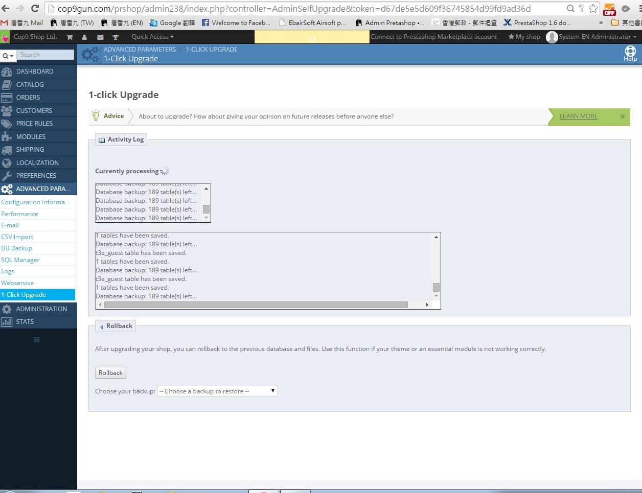

I am having similar problem with bigger database.
I perform a testing for upgrade from 1.6.0.11 to 1.6.0.14 with 1-click upgrade. The screen stayed at "database backup, 189 table(s) left (see attached screenshot)....for 5 minutes ... Then, browser timeout ....The upgrade did not perform when I re-login to BO...
I wonder there is any setting required .... or any manual upgrade steps ...
The problem is that the process takes a while, especially if your database is large (which is impossible to know with the information you provided), and you are likely limited by your servers resources.
I would suggest backing up your website and database separately, and then skipping this part during the upgrade.  You should also contact your host and ask them to raise the max execution time.
