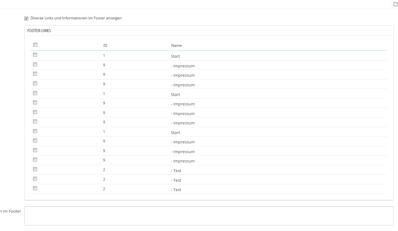

Somepro Posted March 10, 2015 Share Posted March 10, 2015 After upgrading from 1.6.0.9 to 14 I have the cms Pages and cms links 6 times in each shop. Im using Multishop and I have 3 stores Somethin with the overwriting of shop IDs in the CMS links and cms pages might have gone wrong. But I dont know how to fix that issue from Databse site. Link to comment Share on other sites More sharing options...
nuno.note Posted March 16, 2015 Share Posted March 16, 2015 the same thing I Multishop with 2 stores please someone have any solution thanks a Link to comment Share on other sites More sharing options...

nuno.note Posted March 19, 2015 Share Posted March 19, 2015 the module updated, is 2 days ago and fixed the problem due to various problems with multistore, currently I am separate the stores (Water mark module not working, the live edit also not worked, layered navigation not worked,) Link to comment Share on other sites More sharing options...
programmer85 Posted March 21, 2015 Share Posted March 21, 2015 You have to revert manually to previous version of blockCMS. After I updated to 1.6.0.14 with multishop option enabled, I have the same problem as above. I checked the CMS pages on backoffice, it was totally messed up, showing content pages from one shop under the other shop. Unfortunately I saves a content page this messes my database too. So After reverting the module to previous version I have to revert my blockCMS database tabels from backup too. Link to comment Share on other sites More sharing options...
mirekcerno Posted August 3, 2015 Share Posted August 3, 2015 I had same issue. You have to correct in database. cms_lang and cms_category_lang. Give them right id shops. Chears Link to comment Share on other sites More sharing options...
