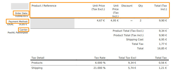

I am kinda struggling with what should be "a simple" modification to my invoice template.
I want certain words on the invoices to show in bold, but whatever i try, it does not seem to work
The orange boxed words in the attachement should be bold.

you could try just increasing the font size
in your invoice template you will see
<b>{l s='Payment Method:' pdf='true'}</b><br />
then just change it to
<span style="font-size: 10pt">{l s='Payment Method:' pdf='true'}</span><br />
You can do the same for other text you want changing
That does indeed work, but it's not what i want to achieve.
I really need those words to show in bold, isn't there a easy way to achieve this?
Best regards,
Kay
Well as you can see from the code,
it SHOULD already be showing in Bold font, but i can only assume it is because the font size is so small for the bold to show up
You could make it all uppercase to stand out more by changing the above to
<b>{l s='Payment Method:'|upper pdf='true'}</b><br />
